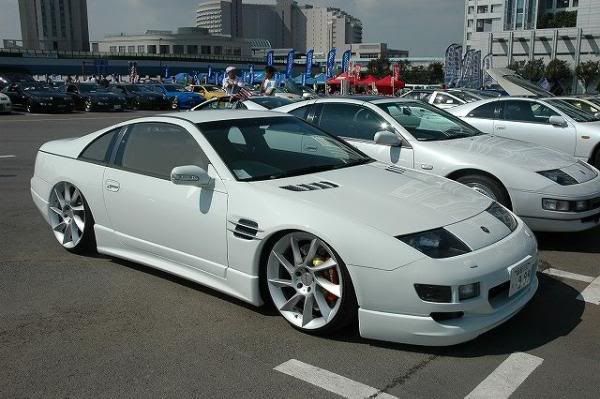

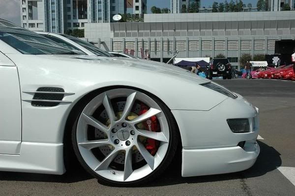

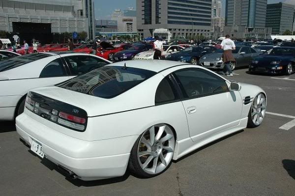

I found these on another forum :
Not sure on what widths are being used though.
+24 rear offset, 1 degree camber
+15 all around, 2 degree camber
+24 rear, 0 camber
+24 rear, 2 degree camber
+20 front, +38 rear:
The rears on all those look like my fronts.. lol :cool:
Yep, those rear wheels (above) look like the fronts did on mine when running 25mm spacers.
How low can you go !!!
Don,t know the stats , just some pics that Kirbs put up a while back :bow:
I bet them wheels cool the brakes well!
Proper rubber bands on them!

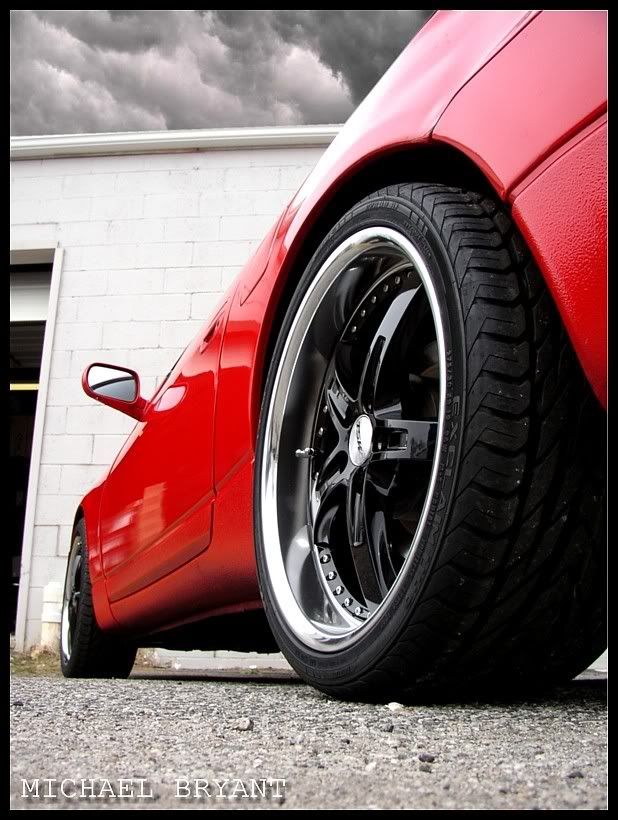

Now this is aggressive offset ! :eek: :eek:
Specs:
Wheels: 17*10 +15 Volks CE28s all around
Tires: 255/40-17 Federal 595SS
Alignment:
Toe 0.0 Front/Rear
Camber 2.7° Front 3.1° Rear
Caster: 10.5
