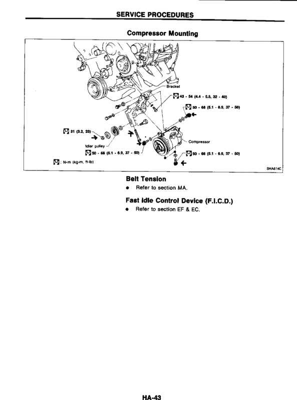

and the air con wont be harmed by dropping pump off its bracket, the only sod is the 14mm bolt that passes at the back of the bracket to attach the pump! small 12point spanner will do it
do you recon you could circle the bolts from the bracket i need to take off to drop the pump please :)
pretty please
HERE YOU GO BUD...
remove belt by undoing 14mm on front of pump pulley, and slackening off ajuster
then as in pic remove the two 14mm bolts marked underneath bracket, then remove 14mm at front and same at back rear one can be an arse, but once pump is off the bracket and carefully laid down so not to stress pipework you will then have enough room to move spanner at more of an angle on mount.

excuse pic cant open in adobe for some reason so had to use the kids program for art lol

So long as your careful you shouldn't loose any gas from the air con, definitely will loose skin from your hands though :wack:

with tricky bolt removal make sure you have plenty of tools, nowt worse than not having good tools, the bolt at the back of the turbo inlet pipe your reffering to should be fine with a 1/4" 12mm socket short bar and possibly a uj. have removed it a few times without any problems.
right i just fitted it woohooo what a long bloody ting.
