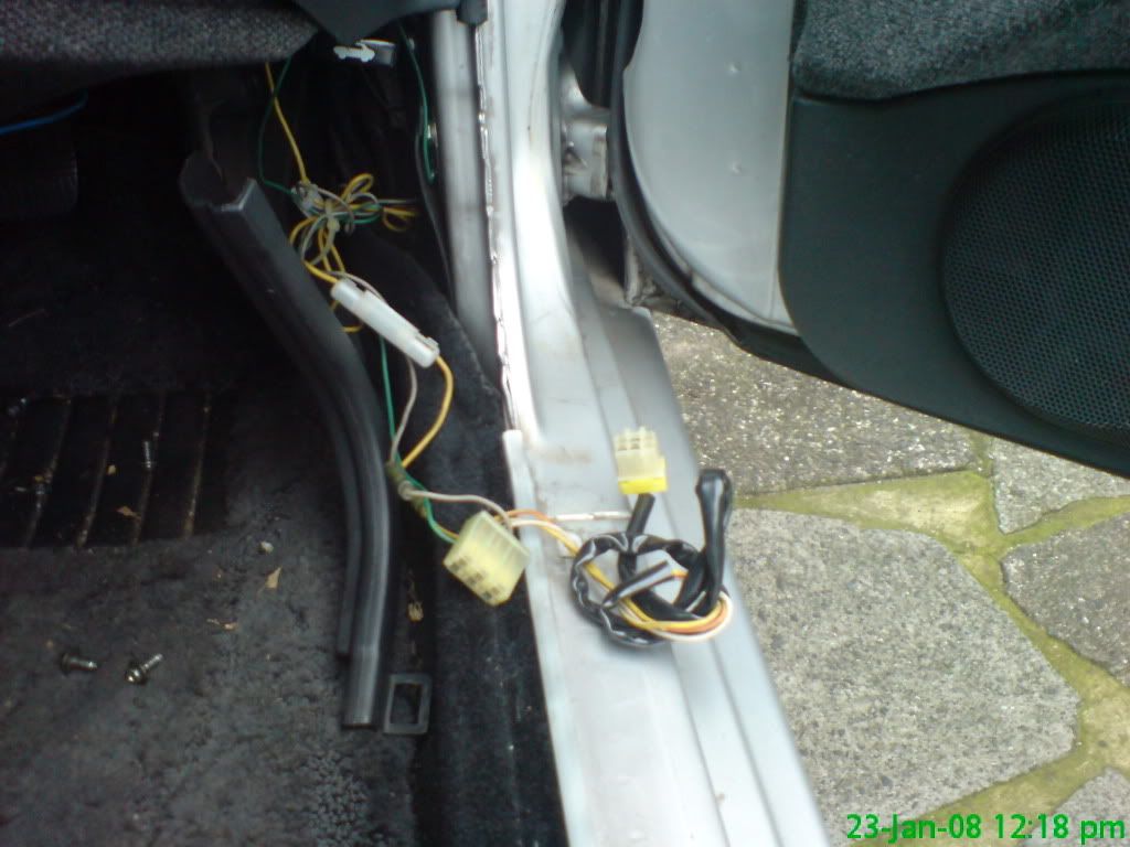

1.first picture is of the loose connectors coming from the aircon ecu.

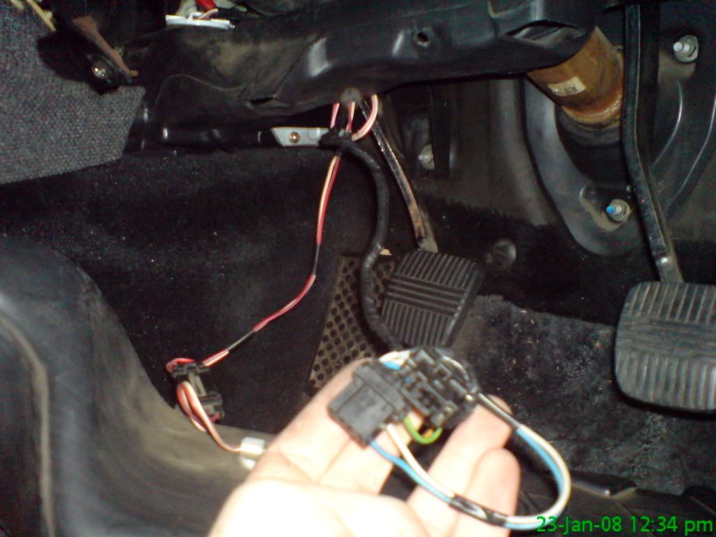

2.second pic is of some connectors coming from somewhere near the fuse box. think they might be something to do with the antenna or radio.

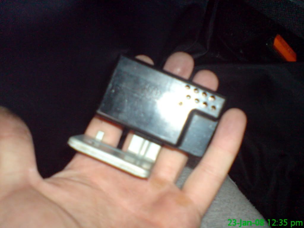

3. third pic is of a box i found in the arm rest compartment when i bought the car, i have no idea where it goes or what it is.

1. Not sure...I'll need to compare with another zed....could check tomorrow if nobody else knows before then
2. Looks like Turbo timer (or boost controller) Ignition harness
3. Thats the Buzzer/Chimer that sits behind the Speedo thats been removed

so i dont really need the buzzer thats just annoying i suppose.
and the turbo timer...... these cars didnt have standard turb timers did they? and if u think its the boost controller wouldnt my boost be affected.. im confused?

I'd say they were from a aftermarket turbo timer or aftermarket boost controller that was once fitted, but removed before you got it.

but them wires were not originally there, they were behind the dash but i puled them out when i delimited the speedo.

Yeh, I would of expected that to be behind the panel under the steering wheel.

so can noone tell me where these aircon wires go?
Could well be for the mode doors, near the aircon ECU on the side of the heater box

The mode doors change the routing of the hot/cold air through the system. Where, read my posts lol ;)
Looking at the link I posted it looks more like the airmix door motor connectors...
You may have something here..... propbably is the mixture motors not mixing cold with hot to make not so hot or cold air.
