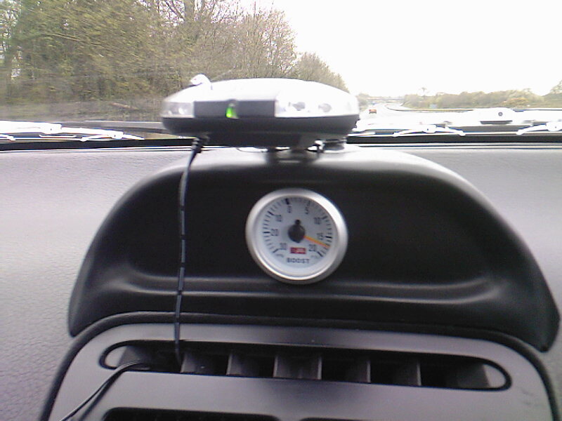

this is with 0.8 tips and servere dett,wish pic had sound you would cringe :(

Is that one of my pods Bud.?
it is my pod selling friend,a whole 3 years ago :)
