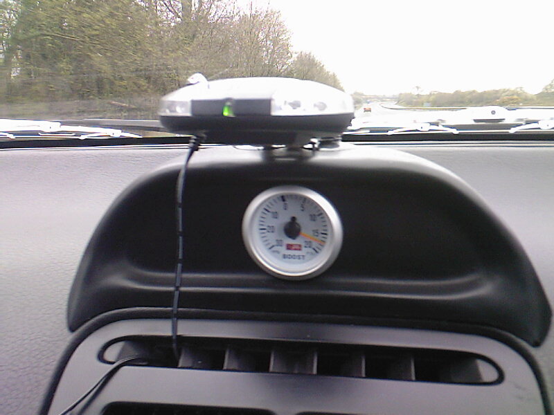

sounds familar,be carfull with this treatment as i drove to scotland in the summer with this and was lucky not to bring my pistons home in a netto bag on the train :rofl: :rofl:
yeah its chipped remember my ecu chip upgrade haha
Oh so you fitted it in the correct ECU in the end then? LOL :rofl: ;)
Just think, you could have had an aircon system that did 0-60degrees in under 5 seconds :rofl:
wow thats impressive maybe il switch them round again.
