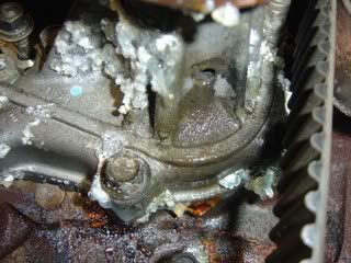

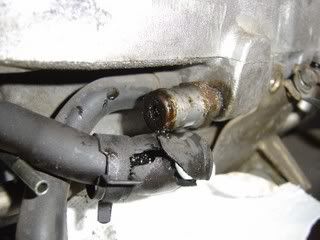

Well i have finally found my leak!!! It was the water pump ffs.
See this link:
http://www.300zx.co.uk/forums/showthread.php?t=98728&referrerid=5526
So looks like Jack was right

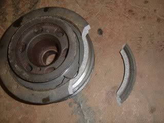

Nearly broke my fingers when pulling the crank pulley off as it snapped and hit my hand :rant:
Good reason now to buy a lightweight one

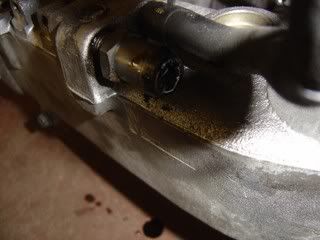

My pcv valves where all clogged up with sh#t too althought the little valves still worked.

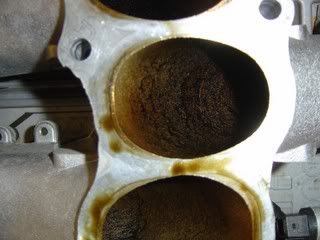

The plenum and the hoses of the tops of the turbos where covered in oil. Is this normal?

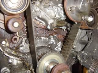

Does anyone know what the gunk is all over the water pump?
Whatever it is looks like the result of a chemical reaction so my guess is coolant reacting unless someone tried to slow the leak down with some sort of sealer and it`s that.
