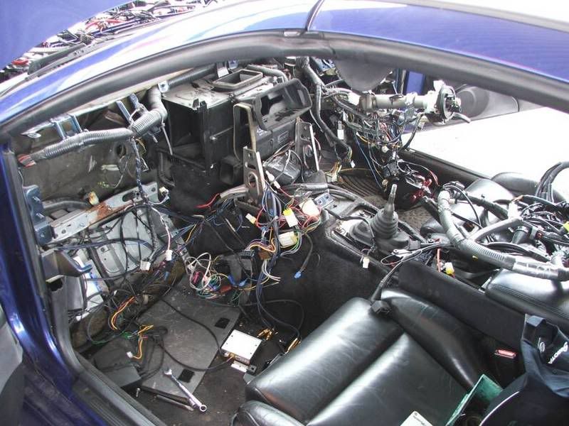

Take the dash out. If you don't you fook about for ever and then endup taking it out anyway. It is so easy to do once the dash is out.
Here's one I did earlier

:rofl: i remember that well, i felt sick that night as i went home leaving it like that wondering how the hell i'd get it all back together. But with help from greg and Mr. F I managed ;)
Daunting task but once the heater itself has been done and you start putting everything back in place you get a big sense of pride that you did it yourself
fook taking the dash out, you would need your head testing to do that. LMAO no offence mark. Manuals are fiddly, as your removing the pedal, but an auto can be done in 3hours from start to finish after you have carried out about 30 off them like a hamster under the dash in the middle of winter :)

God thats i sight i dont miss, I remember doing mine and i must have smoked 40 fags trying to remember where everything went!

I had the common sense to bag each bit as i went along, the problem was i couldnt read my own fecking writing!!! LOL!
No doubt Greg, but most of us have never done one, until we do one.
How many Zeds have you seen with splits and tears in the boot trim because people haven't unfastened everything in the right order to take the trims out. Same with the dash out job. when I've done a few i might chance doing the heater matrix with the dash in. Until then I still think anyone doing it first time is better removing the lot.
true, although there is far less to get wrong by leaving the dash in, It also depends on size as there 0 room with your head under the dash :D
