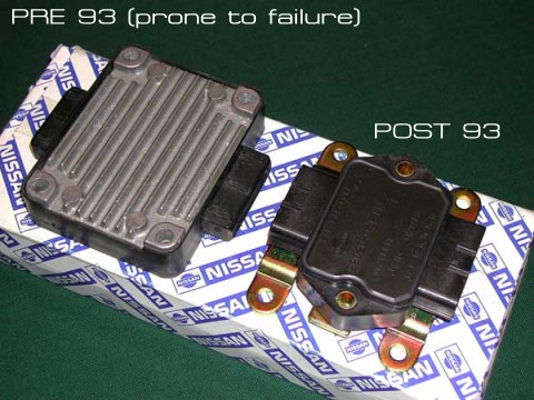

find someone with a working unit and ask iff you can do a 15min swap in your area mate
That´s what I was going to propose.Good Luck :cool:
I have a working unit that you can have a to try and see if it helps. My car is off the road and will be till at least next year sometime. I will need it back but I won't be in any rush. I'm on holiday this week and next so I could get it sent out before dinner time tomorrow if you want a borrow. Just PM me your details if so.

Check your Temp sensor to make sure there is no corrosion on the plug. Or change the temp sensor. ( located in front of the engine on top of the water pipe.) There are 2. One has a single prong(water temp gauge signal) the other one has 2 prongs.(water temp ECU signal) If the 2 pin plug isnt making good contact it the wire then it make the ECU think the car is running hot and you will run incredibly rich and it will retard the timing.
Or
Check your ECU for codes.
http://www.ttzd.com/tech/diagnostictech.html
Usualy the PTU isnt the culprit, its the PTU adapter harness. Also check for corrosion here.
If this doesnt help i sugest these comon things to look at
http://twinturbo.net/ttnetfaq/FAQpages/hesitate2.html
JT
