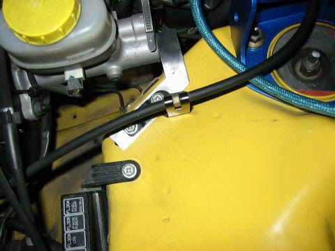

While i was checking the maintance section he made i found a picture of this
Which seems to show a different designed brake master cylinder to what ive previously seen on all zeds, does anyone know anything about this new cylinder.
i don't think that is a new cylinder but a bracket to stop it from moving which will apparently improve braking, they are very cheap to buy.
according to the nissan press release there is a difference in brake master cylinders
http://www.nissan-global.com/GCC/Japan/NEWS/257a.htm
So it looks like it is slightly bigger than previously and the servo/booster has been changed.
This one definitely has a brake stopper as well which improves the feel of the brake pedal. These are cheap to buy and easy to fit. well worth it IMHO...
