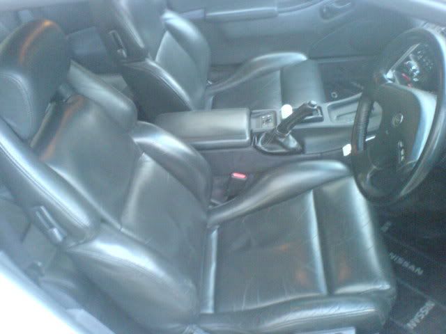

Dove grey sounds nice and i think it will look great overall. The only thing i hate about some re-trims is when the leather is a bit 'loose' in places so it looks like a bad fit. Even in the pic above there are a few ripples in the leather. Thats probably a bit picky though
I know exactly what you mean. I'd be fitting some extra padding in the bolsters. Jimmer has done this and his has no ripples or anything. Unless you're getting the seats trimmed rather than fitting a kit, unless you increase the padding to combat age, then you'll get slight rippling. TBH, the above is very good. I've seen some really saggy crinkley ones.

Your interior looks in great shape!
Heated seats - Rare option. Its where that blank space is on the Mirror switch.
Those seats look nice. Poor retrim of the Centre arm rest though.
