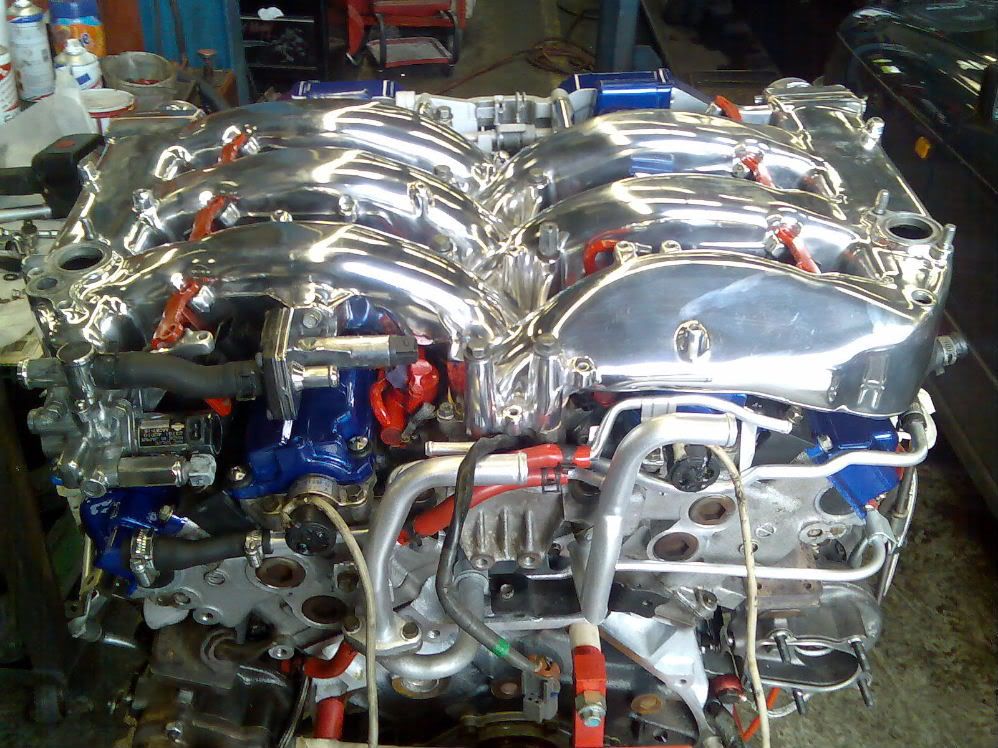

Just going to spend a while looking at the nice shinny engine above.
Darrell
21mm dude ;)....as posted above
Cheers mate. Was dazzled by the shinny engine above.
Darrell
Darrell
I wasn't sure about putting it back in the engine bay or to just keep it on the engine stand as a feature in the lounge.
