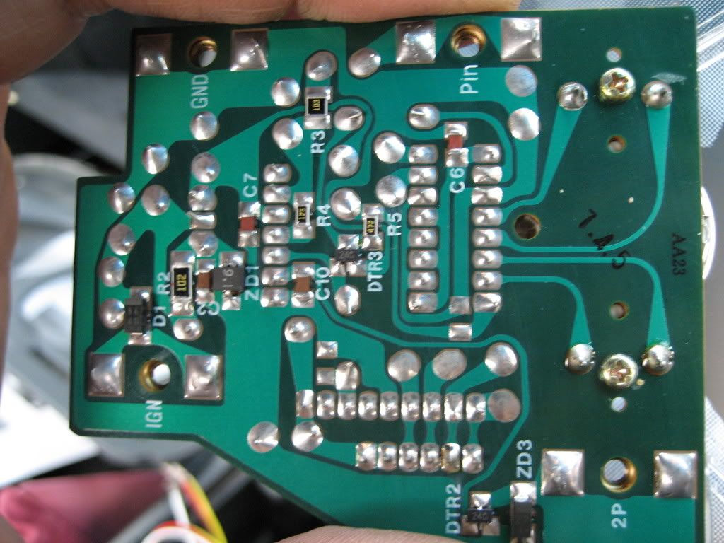

1) where is the pot to calibrate the speedo??? any ideas how to adjust it without a pot, as it is way out since my manual conversion:
2) a)new km/h converter fitted - still got power steering problems
so b) where is R10 that needs replacing., mine only go up to R5:
3) where the @**$@ is the reversing bleeper, i can hear it from somewhere behind the dash, found the lights left on / too fast bleeper easily enough
[sIGPIC][/sIGPIC]
looks like you have a series 2 speedo...
there's no information on how to modify these (afaik)
