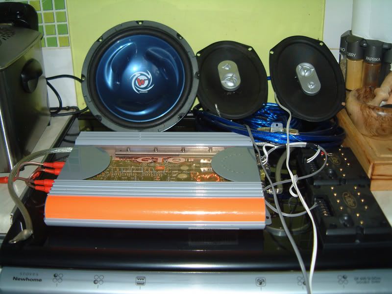

I have just aquired this little lot 10" 600W Amp. 500W sub. 100W JBL 6x9's and the leads. I need another head unit but thats being sorted soon. Now what I need if possible is a link to or some advice about building something for it all to fit onto and into the boot of my 300ZX please. (maybe a template sort of thing)??
Your help is much appreciated.
