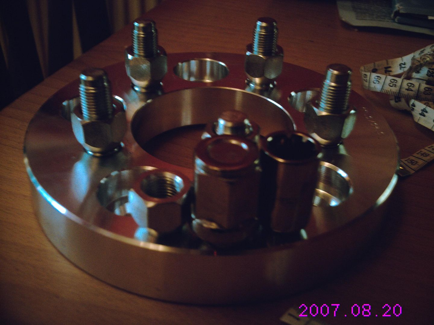

Finally got a set of spacers/hub adaptors from my 300zx, but idiots supplied 20 nuts with the wrong tread. As you can see in the pic I have the new nut on left, std 300zx one in middle and tuner 300zx one on the right. Anybody know where i can get M12 300zx nut but as stumpy as the one in the pic (on left)
if im looking at the pic right, you can just go to the scrappy and pinch them from old nissan micra's sunny's and so on, make sure you get coned one's if you spacer has a cone shaped seat (if ya know what i mean)
wont the micra ones be the same? the std ones are 35mm long but i need 20mm long ones. the spacer has a coned dish.
oh i see, not really sure, you may have to go to a machine shop and get them made, i know zeds have a strange thread on them, make sure you get coned one's other wise they will come loose
actually thinking about it, maybe a machine shop can mill them down to the length you need
not sure bud, you could always try getting 20 locking nuts, they are smaller in length, may be a bit expensive
nissan cabstar truck, cheap as chips in scrapyard
do they have the short wheel nuts
