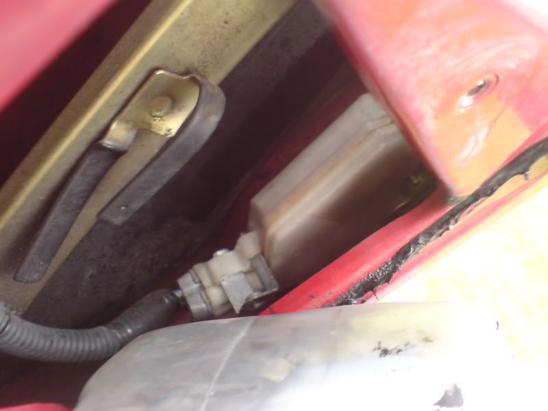

Hi mate, this is an example of one of the door motors. I presume they are standard ones. The passenger side one I fitted a couple of months ago, brought second hand from someone on here after my existing one made strange noises. However, since the central locking wasn't working at the time, I couldn't test it. The driver one is also recently fitted by the previous owner, again a second hand unit.

Have just finished on the car. Passenger side has had WD40 sprayed on it. Has made no difference at all. The lock just doesn't move far enough when you use the central locking. Driver side stopped working again this morning, so used WD40 on that side as well. Again it made no difference. However, I have fixed it by adjusting the rod that comes with the Clifford actuator that they installed. Where this joins on near the lock, I undid the screw, moved the rod along a couple of millimetres and then tightened up. Locks perfectly now :)
