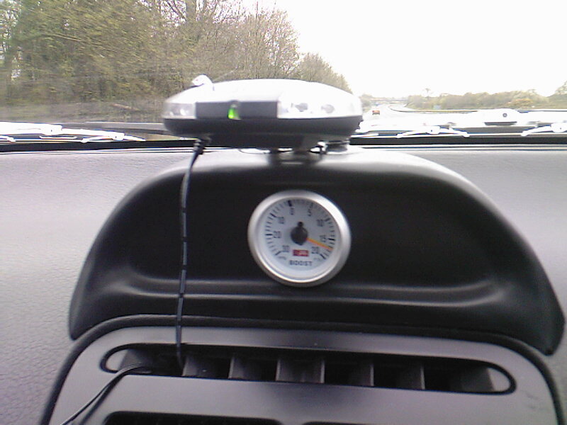

and dont do this after you,ve decatted on standed tubs :rofl: :D
