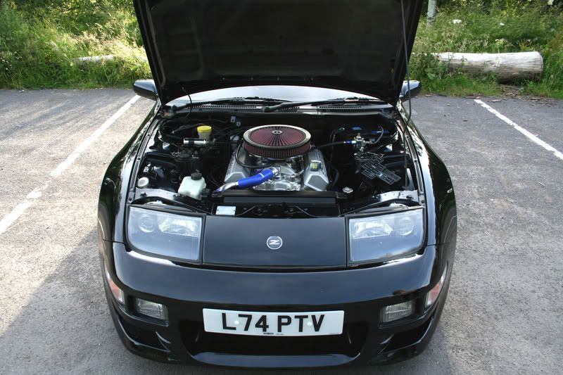

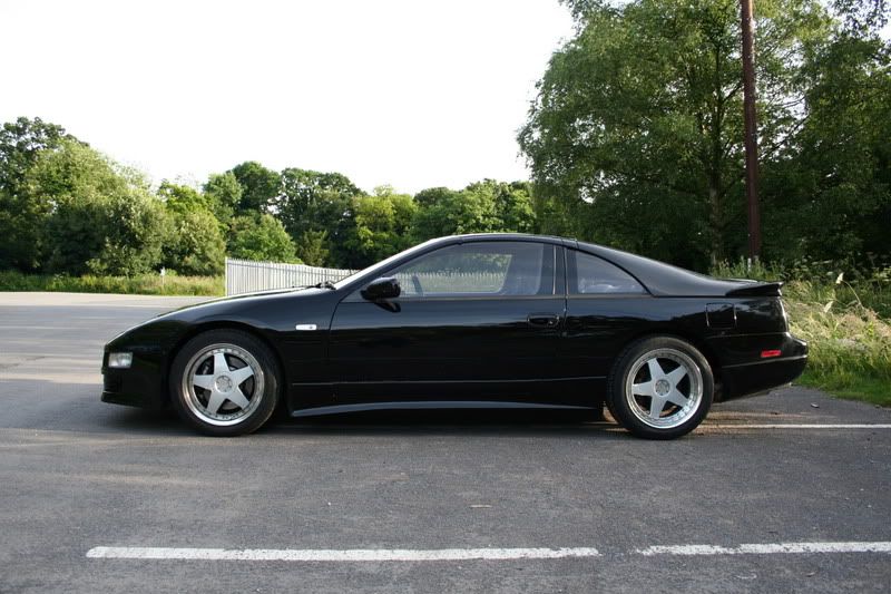

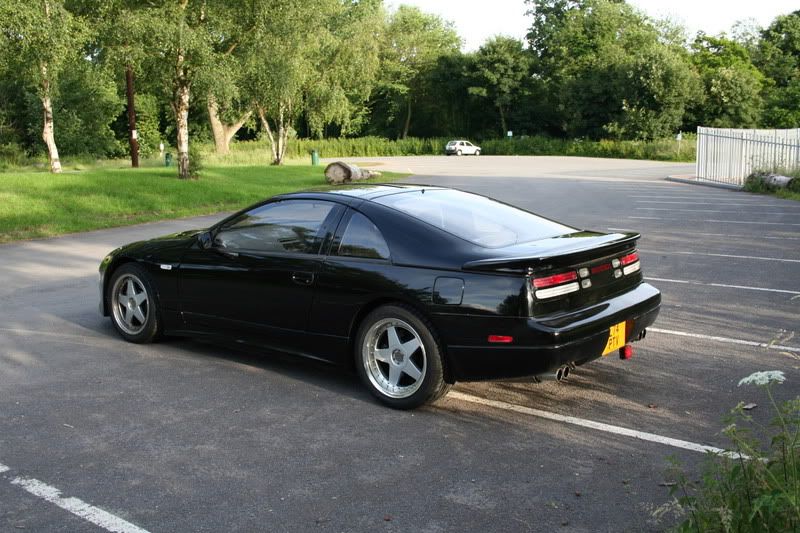

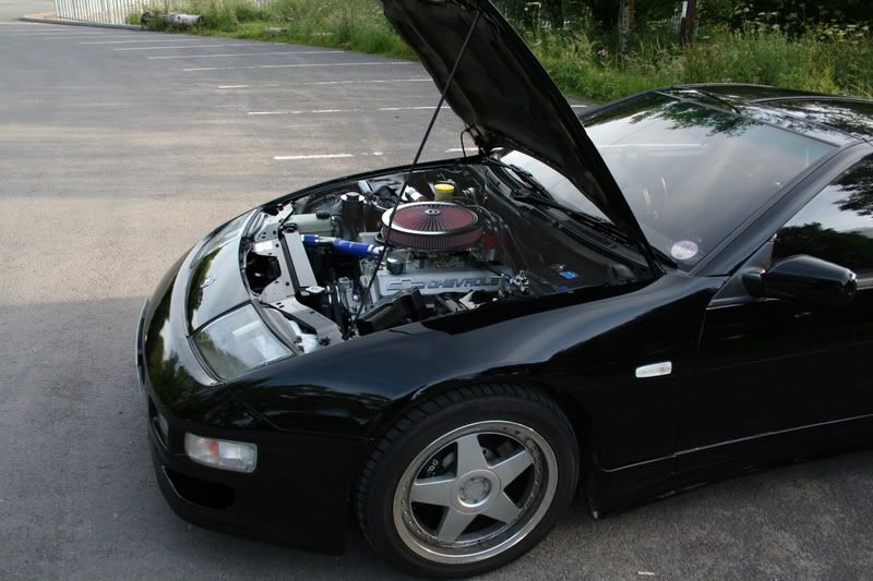

Managed a few pics inbetween showers,
Everything's working and it goes ok, couple more rattles to source and fix, and need to mod the exhaust slightly as there's an annoying boom at around 1400rpm, although the exhaust is fairly quiet really.
Have been replacing some of the stupid rock hard ES poly bushes at the rear, with OE type, to quieten down the diff. Sounded like a 1950's bread van 1st time out.
Am contemplating my next step. Part of me wants to add fuel injection and then stick on the supercharger. Another part wants to sell it and start afresh.

Top work how do you find it handles now and what is the weight differential between front and rear?
BTW noone here is jealous on all the room you have to work in the engine bay :D
Oh, and thanks for the positive comments chaps.
Will get some interior shots up at the weekend hopefully.
Looks real good Keith, very high standard of work there. Well done...
I always like stuff that looks like it came like that straight out of the factory :)
Cheers, that's my remit these days, make it look like it could have come out of the factory like it.
It seems to handle ok, but I'm only slowly creeping up on the limits of it's cornering power. I've grown up with straight line blasters, this is the first time I've had a car that actually goes round corners.I still haven't come to terms with how much grip there is!
According to the ride heights front and rear it seems to have gone up a bit both ends so it's a bit lighter, but probably similar distribution.
Don't know any figures for it yet. It was built with supercharging in mind so the cam is quite mild and so would guess in the 300-350hp range. Torque feels good tho' so must be around the 450 mark.
