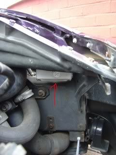

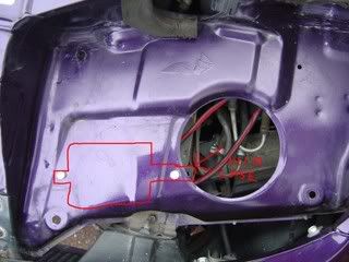

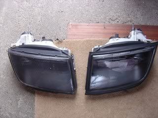

Just taken the headlights apart to clean and also to fit my HID kit from Dan at DTA.
Could not believe the build up of dirt.
Also HID fitment for those interested.
It has taken me 4 hours and all I have done is take headlights off, clean one of them fit it back as well as installation of both HID units.
Cant wait to do the other one :wack: :headvswal
Thanks
Paul
what method did you use to separate the mastic bud and what did you use to re-mastic
Hair dryer (not mine :nono: ) and just warmed it back up to let the old mastic reattach itself as per this guide: http://www.aus300zx.com/tech/headlight_disassembly/headlight_disassembly.htm
cheers bud,just wondering if it was the same method as when i done my rears i had to put the buggers in the oven and dont think i can con the missus the second time :x:
Just make sure you heat it steadily and evenly or it could crack , i used an electric blow heater and warmed the whole glass in one go , also use a wide bladed paint scraper to prise the glass up so it won,t chip the edges . HTH
