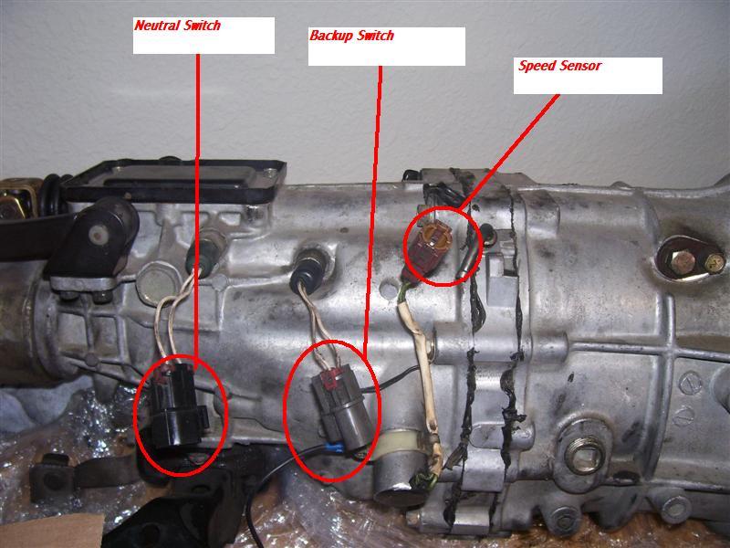

Wheres the neutral switch please ?
On the gearbox, its mounted at the rear of the box. its behind the reversing light switch.
You may be able to ge to it through the gearshift hole, but im not sure.

Please see pic , can i earth that wire directly cos i dont know what is connected or not without getting it on a lift & the garage that done conversion is closed for hols.
Or must i connect it
please advise
pin 44 on the ecu will need connecting up to the nuetral switch and then the nuetral switch will need connecting to earth,or you can just earth pin 44 constantly, this wont stop it running in normal boost its just a false indication in nuetral

Thanks for the replys guys, but no cables/sensors were cut when autobox was taken out. Im hoping its a matter of a plug in?
Getting it a lift tonight , any advise welcome
Well the auto box is different - it wouldn't have neutral sensor in the same place.
and also the Auto ECU has extra programs built into it that the manual dosent so now the car is manual it wont need these extra programs, thats proberbly why your getting code 54 as it cant detect the Auto gearbox anymore

As has already been said, you dont need to do this as pin 44 is only earthed when the box is in neutral so timing is ok when driving. It's only affected when in neutral so don't worry about it. The only adverse effect I know of is that the engine idles slightly faster than it should.

I hooked up the neutral switch on mine, you notice the difference when you put it in and out of neutral.
