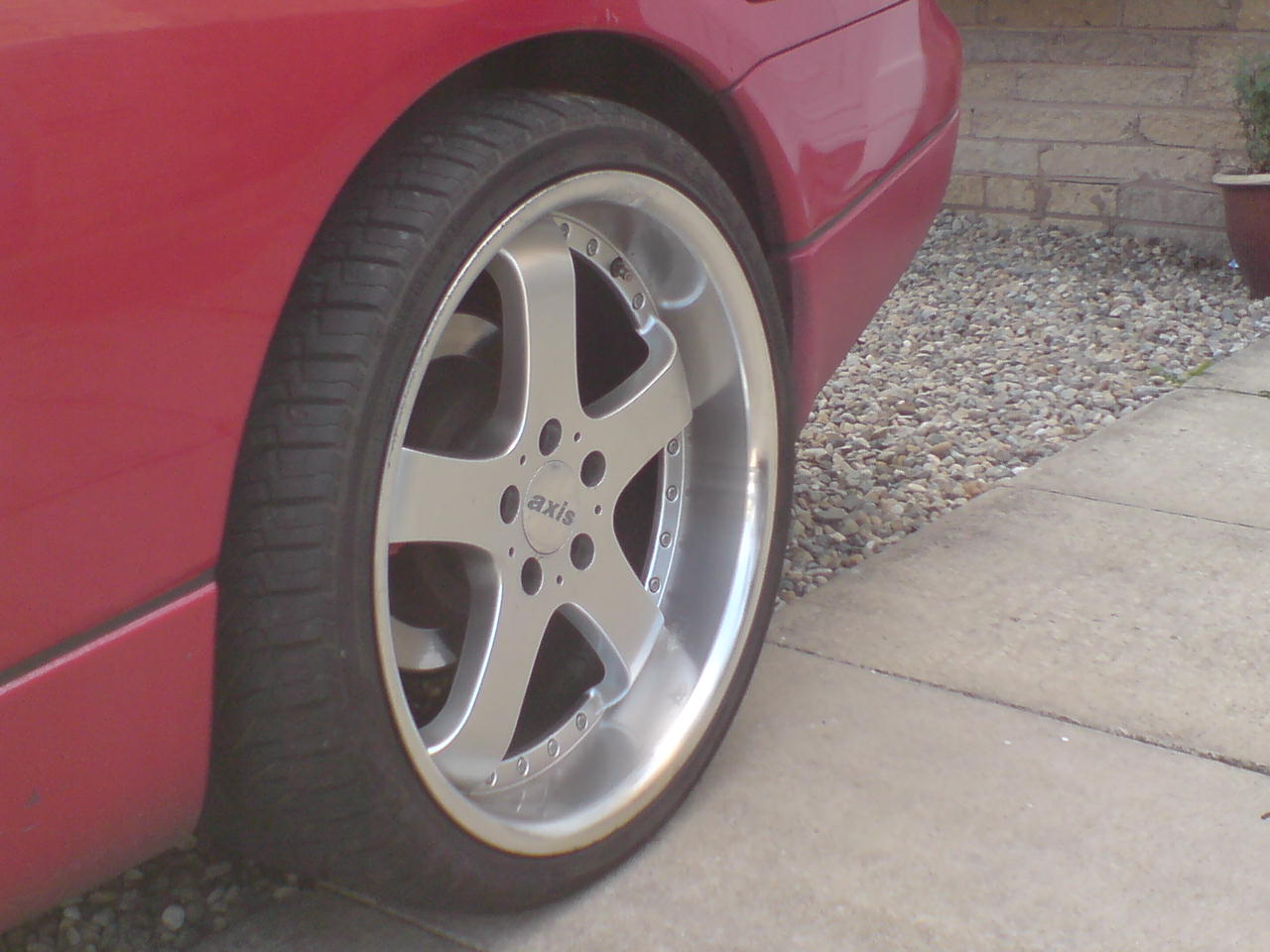

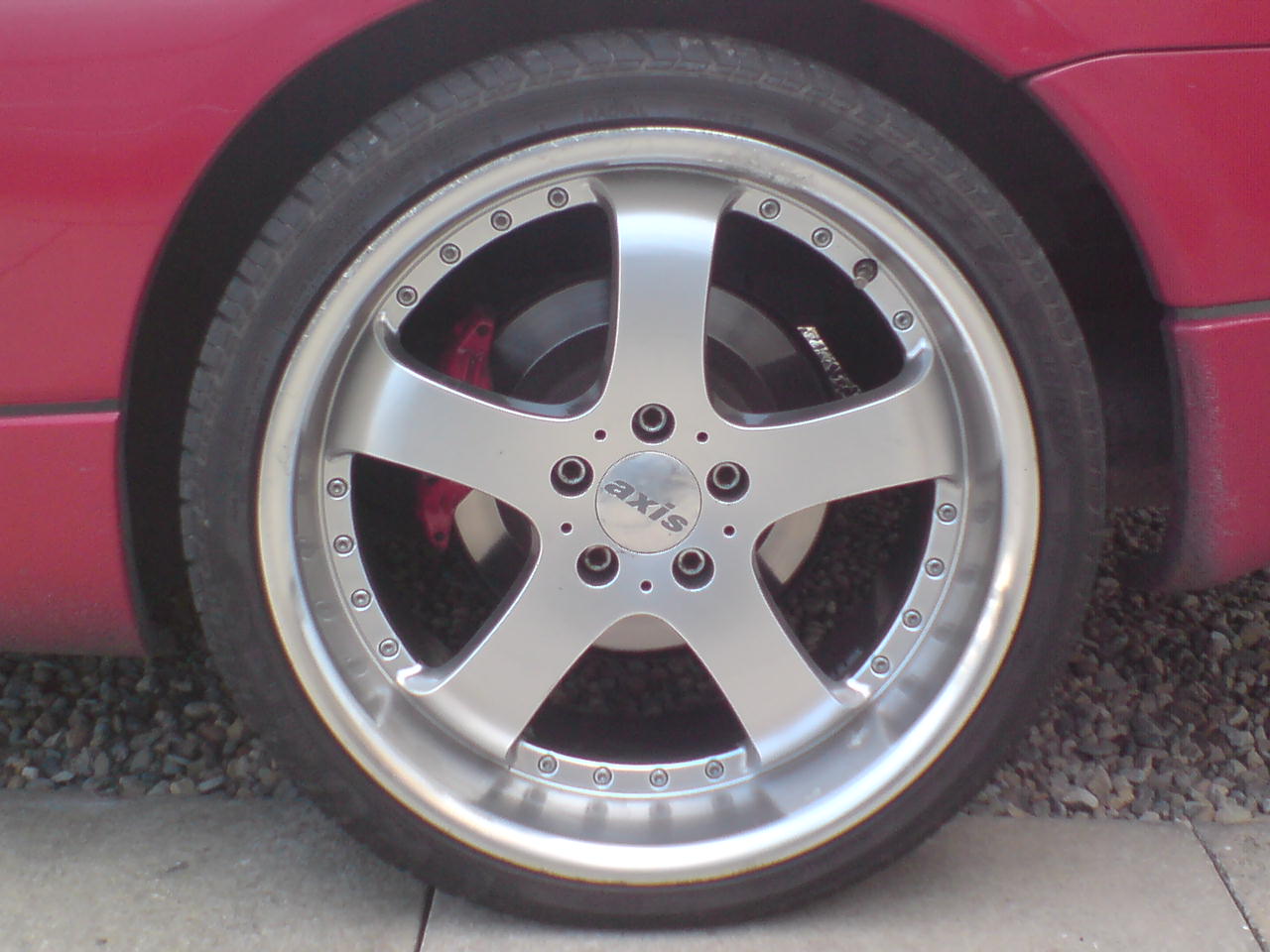

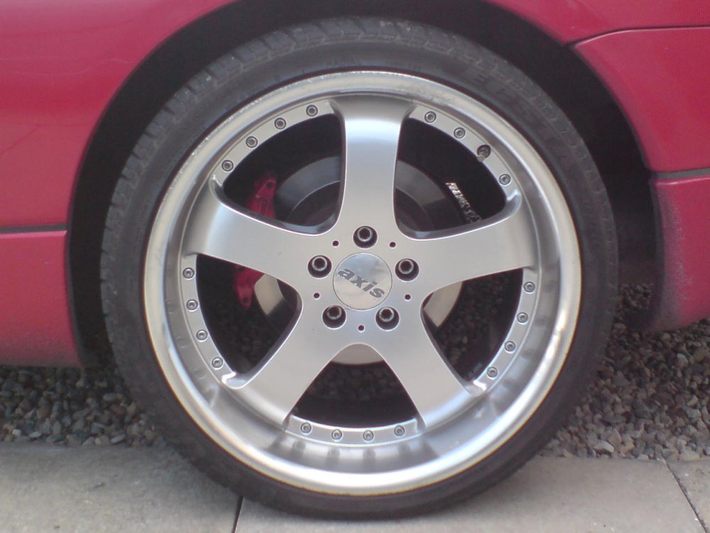

Have got a set of 19" axis deepdish already :hyper: :hyper: they just stick out too far and scrape on arches whenever i go over a bump in the road :headvswal
Which Axis wheels have you got? :shock:
My dream wheels have always been the Axis Se7en's :bow: :bow: :bow:
One day...
Dont know what the name of wheel is buthere is a pic for ya.
