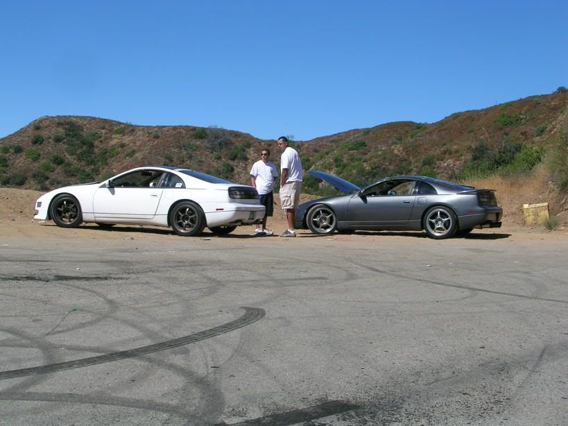

Like this? Quite a few guys in the US do it, especially in the sunshine states.
It doesn't look that great, but certainly better than some bonnet vents I've seen.
Took these in California last year when I ended up going to a US 300zx meet, you can't see too well, but the white one's had it done.

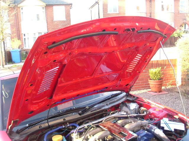

Coollouvres, cost about £100, will need to have the bonnet repainted after its done, he only works Saturday mornings, you go down, he takes the bonnet off and an hour later you have louvres.
I like the way yours are angled...if you get my meaning, rather than just a scuttle pressed into it. It kinda flows with the bonnet lines.
The hardest part is deciding where to have them cut, once its done theres no turning back, they look very subtle in real life, the first picture was taken purposely to show them off, the second picture is a better representation of how they look.
They are done in exactly the right place. I've seen Z bonnets with the bloody thing covered in them. But yours is subtle, in the right area of the bonnet and looks good.
You can choose width, how many and what angle, the only real constriction is the strengtheners underneath the bonnet, I had one cut away so the louvres couls be placed where I wanted them, and so did James when he had his done (thats the one that Wozzer has now)

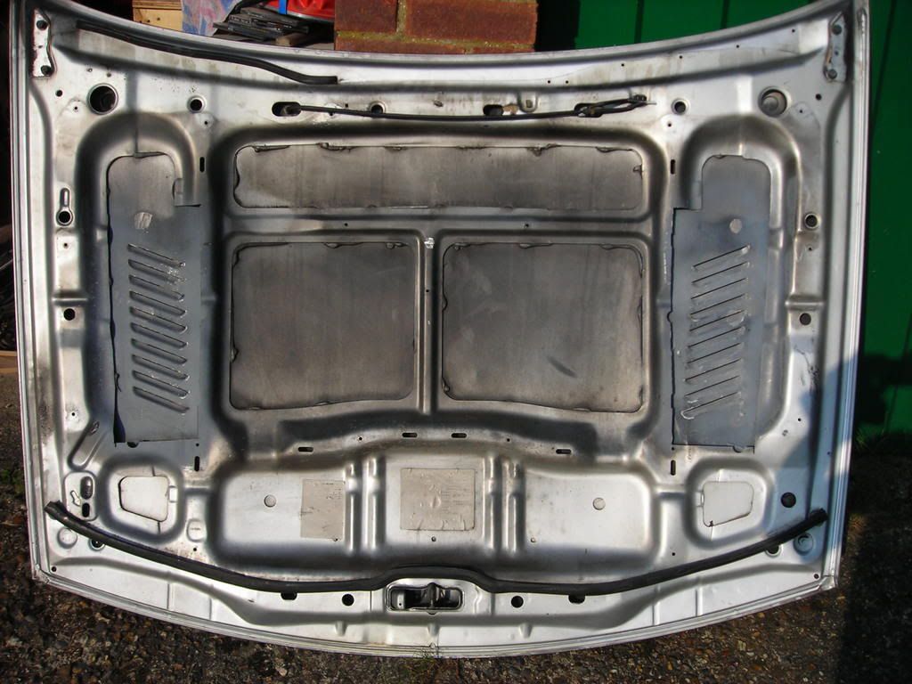

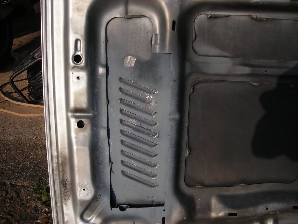

this is what they look like from the under-side ...
looks rather.... challenging! i bet cutting the stiffeners without catching the skin is an interesting job :smw:
Not really, just give him the bonnet and he will cut the stiffeners out before he does the louvres, all included in the price.
