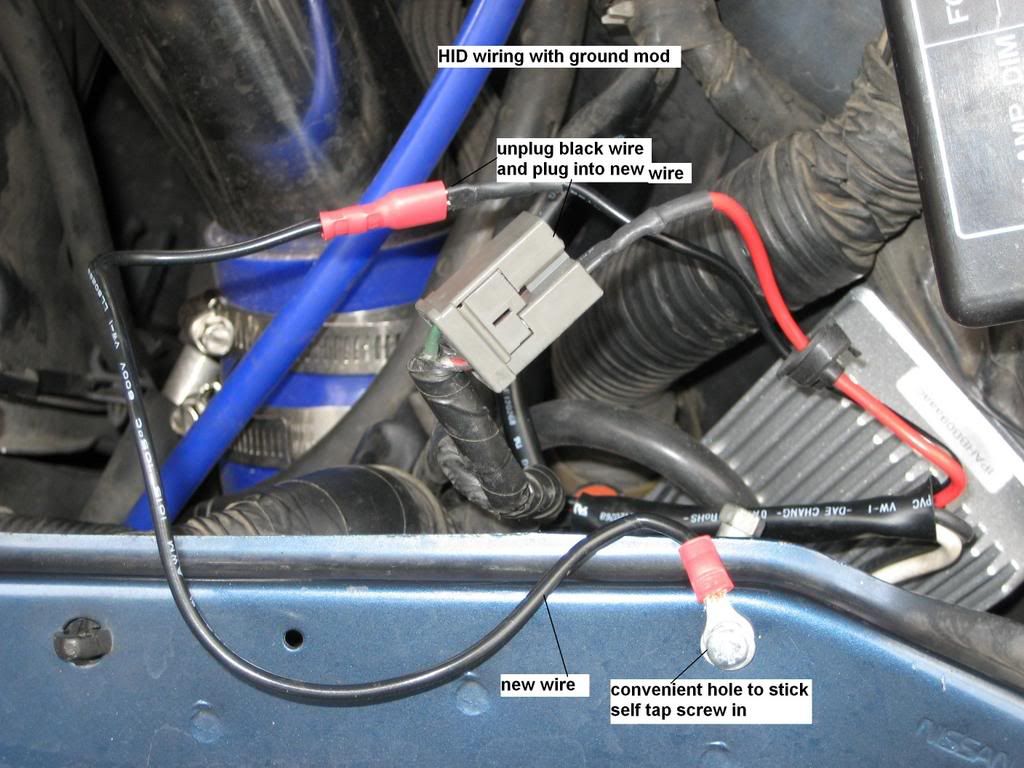

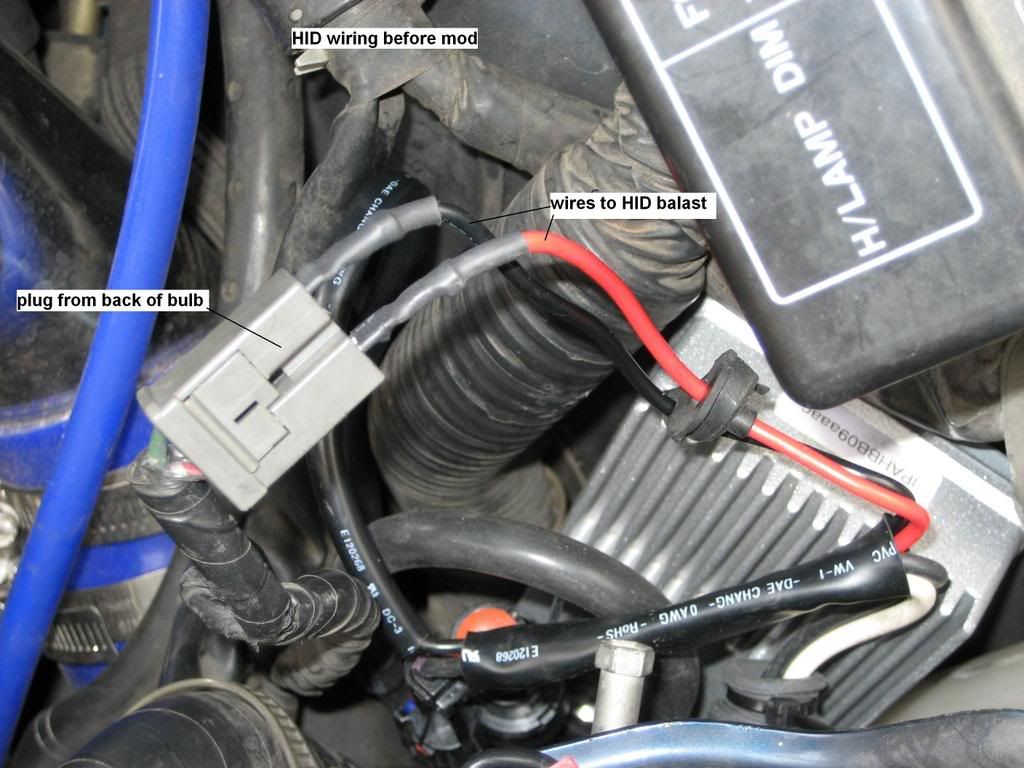

Have you got a pic of what you did Bud(For Thee Old) + maybe a sketch Please.
or do it for us :rofl:
make 2 small wires ring crimp at one end and blade recepticle crimp at the other end, (alternativly cut blade crimp off existing wire and fit ring crimp)
fit as pictures , unplug black HID wire from where it is and via new wire screw it to a convenient bit of chasis
[sIGPIC][/sIGPIC]
So what you are saying as I understand it is,just connect the existing earth wire that comes with HID straight to body earth ? Is this correct Bud? :confused:
Yup, that's right. If plugging it up to the body doesnt work then just plug it direct to the battery like mine.
Just dont flash the high beams with the low beams off. Like I've said before, the only time you'll be doing that is during the day! In which case a nice hand gesture will do fine!
