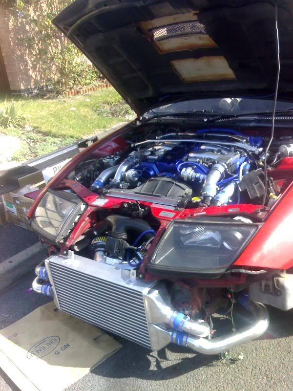

pics of it fitted
you also have to chop up the bumper and the bar that the fogs sit into its alsot to cut offf to should be at the back of the manual also the horns need relocating and 2 small brackets either get bent or removed cant remember tis an easy job tho
Those pics look just like mine :dance:
I just want to comfirm a few things to make sure i fitted it correctley. Firstly the bar along the front wont now fit which holds the fogs, i have ordered ducts anyway but is that not a issue not fitting the bar back on?
secondly i could not get the back pipes to align up without removing the bolts which holds them in place, these pipes are the ones which connect up to the shiney new Greddy ones.
Thirdly why do i still have loads bolts left over??? 2 mahoosive bolts left? some funny double end fredded thingys and lots of nuts and washers. Oh and not forgetting those really thick washers well look more like spacers what were they all about?
I got a lil worked up in the process turned green and snapped a head off one of the bolts haha, banner - Hulk rar......... wooopsie too tight.
youve done it right half the bit i had i didnt need the thick s[acer washers i used on the 2 mountings at the bottom to stop it cuffing the lower cross member the pipes yea do need a bit of adjustment that front bar for the fogs can be used but you have to cut it in half and just use the mounting bolt holes for the fogs but youve got vents so no worries their hth
Also my under tray no wont fit.
No fairness you have greddy labeled silicon bits, mine are plain lol.
thats ok you have a moohoosive front mount now sod the underpants/tray and justv tip-ex the greddy bits on lol
