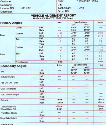

heres my report the camber is way out they couldnt adjust it as my car doesnt have after market adjusters on i was just wonderin whats best to get the strut top adjuster or adjustable top arms????
You really could do with ajustable tie bars, ajustable front camber arms and the rear camber arms. Give Smithy a bell he does them all. The SPL ones are the best. Rock solid. I got trix or what ever they are called on the rear and they arn't as robust as the SPL.

ta for the help i went to pro tyre in bristol an they were pretty help full but i did have to correct the kid a few times, dunno how much it would cost but they only charged me for a check an report for adjusting my track rods which was good @ £23
