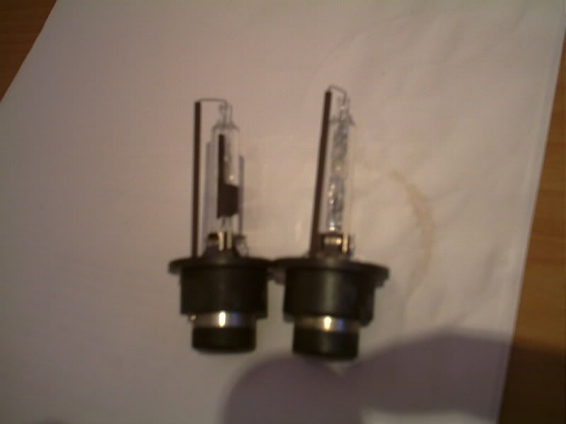

Vijay have you got a pic of the bulb ,i,ve aquired quite a few Merc and Peugeot ones which mainly have a round fitting surface , if they are the same as yours i can pop one in the post for you :D

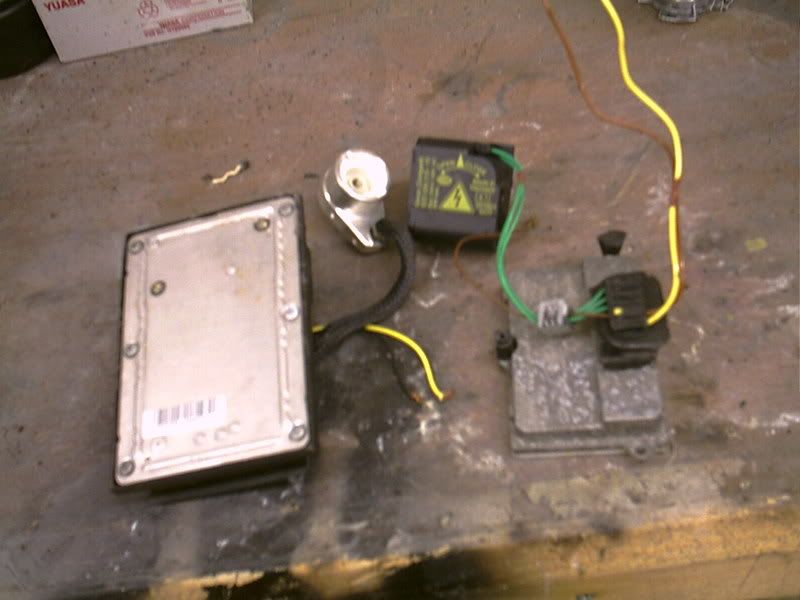

I have had lots of problems with my 'ebay hid kit from oz'. I have isolated the problem to one ballast pack. The other is ok. Both ballast packs have a rubber surround.. that i now know isolates it from other electrics. I have brand new halfords 700A battery fitted as well. I have a jap import zed. Dunno if that is an issue as they dont use H3 regular bulbs.

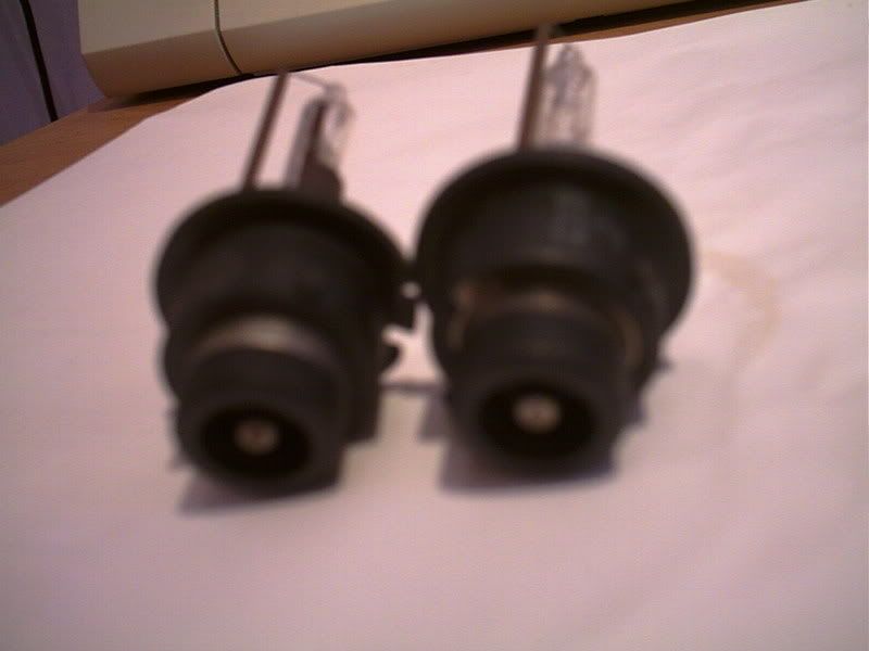

The one on the left is a Peugeot one and has a black strip around the bulb :confused: the right one is a Merc one and looks like it,s the same fitting as yours , p.m me you addy bud and i,ll pop it in the post , don,t break it , been told these are £100 each from merc :shock: :shock:
Camera,s crap on macro focus :smash:

Hiya bud , got some Peugeot or Merc fitment ones , what type of bulb connector have you got ?
Peugeot on the left , Merc on the right .
£20 delivered , had these in mine for 2 years without a problem :hyper:

Boldy thanks for the offer but i have already gone for a HID ballast on ebay for £35 that has the right connectors i need. My original HID kit was specific to my jap import zed.
The HID ballast looked high quality, umm
boldy,i'll have the merc ballast and bulb for spares for my hid seen as its the same kit i bought in a group buy a few years ago

They give you a very bright blue-ish light and as Danny mentioned the kits he supplies are just a direct replacement for the standard z headlight bulb , so it,s an easy job to fit them , where as the bits i,ve got are only suitable to replace parts for an early kit from a few years ago which involved modifying the bulb mounting itself to take the round fitting of the bulb .HTH

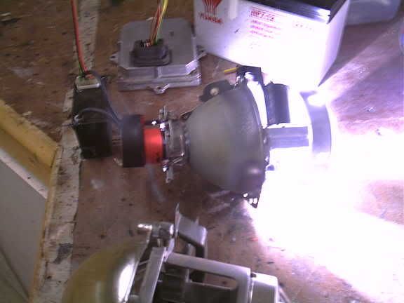

Just to show how bright these are .
