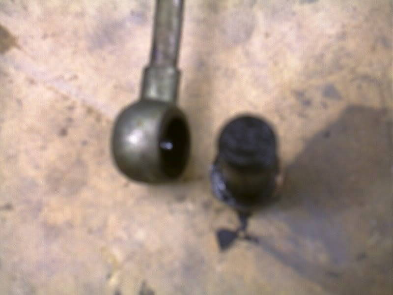

ONE HORRER I FOUND , A COMPLETELY BLOCKED TURBO WATER FEED !!!!

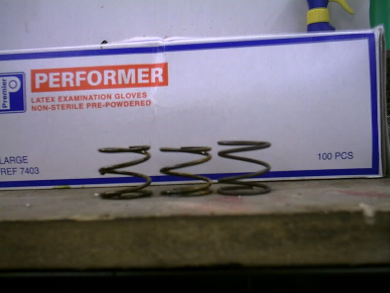

VVT SPRINGS HAD BEEN COMPRESSED !! (new one on the right)

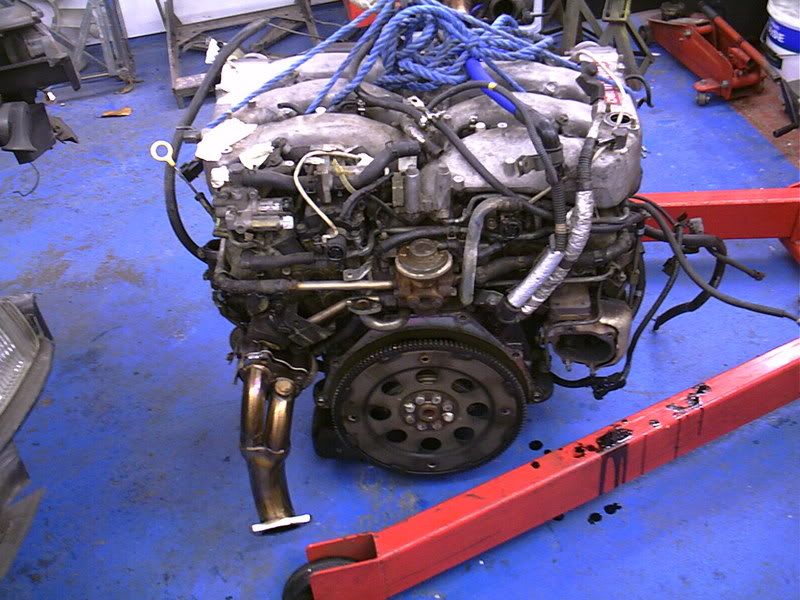

THE END RESULT WITH NEW TURBO,S, REAR MAIN SEAL , VVT SPRINGS , ROCKER COVER GASKETS , WATER , PETROL AND VAC LINES , POLISHED PLENUM AND REMOVEL OF A SHED LOAD OF CRAP :dance:

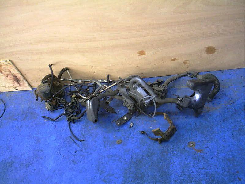

ALL THE CRAP WE TOOK OFF , AIV,s, EGR , CARBON CANNISTER AND LOADS OF PIPES

Stunning. Nicest looking engine on here!! Nice amount of bling, but not too much, the blue goes really well with the silver and the chrome.
Looks great. Wish my engine looked like that!
that looks fookin ace!!! :bow: :bow:

ps. so THATs what the VVT springs look like - little blighters in my engine gave up the ghost months ago :smash:
