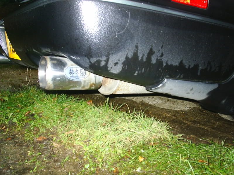

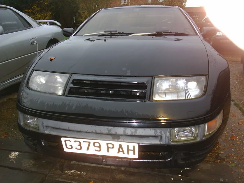

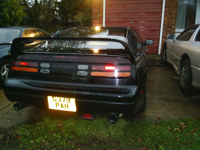

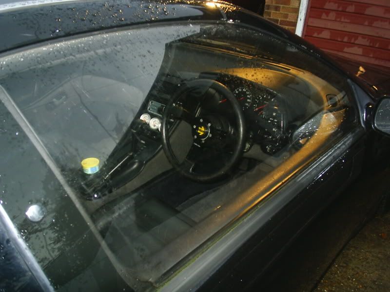

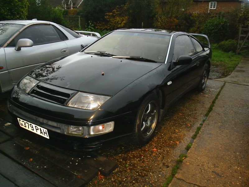

I have worked on alot of turbo cars from simple TD's to supra's GTO's etc etc oh and I have my own zed too, anyone wanna see a pic ??
Thanks ;)
