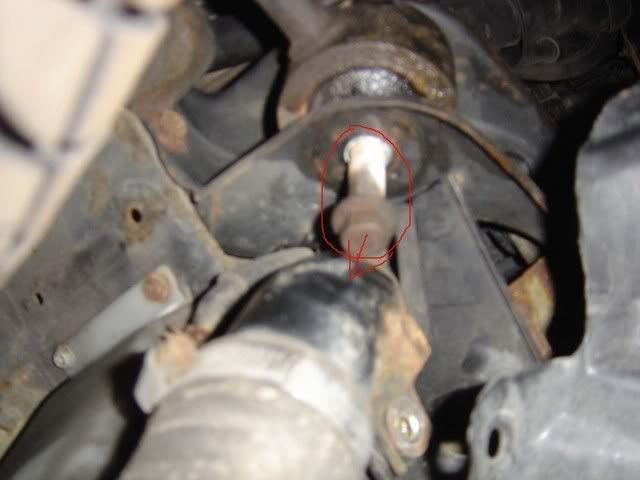

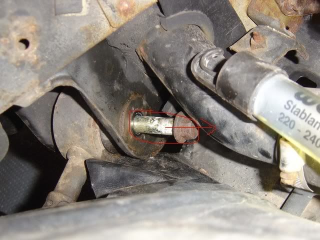

1.Trying to get the front tension rods off but the bolts wont come out as they hit the intercooler piping.
Is there anyway that these will come out without having to move all the intercooler pipe work?

As for the bolts, could you cut them and fit new ones the other way around ?
The bolts are tight but you can get them out, I think I levered the pipes a bit
Is this the normal way for these bolts to be fitted or has someone had them off before?
Never heard of this problem before.
If you unbolt the other end of the bar can you bend it around to get some clearance for the bolt to come out?
Hi,
Been there - done that - assuming you have unfastened the other end first - you can then twist the rod so that the bolt can be squeezed out.

with abit of "jiggeling" and "easing" the IC pipe over abit they will come out, as for the compressor, you need a half decent sized one with a fairly good CFM rate, them little things just wont cut the mustard im affraid.

I have a feeling that the bolts are shouldered and only fit one way. I didn't take mine out myself but I watched my local mechanic do it ad he had the same problem. I think you can also loosen the bracket that holds the tension rod that bolts to the chassis.

as andy says slacken the tension rod bracket or remove alltogether and out they come :cool:
Wot Greg says. Just undo the whole bracket and then work on the bench for the rest of the job. just done a pair yesterday like that. Dead easy. Off in 10 mins.
Done it. Cant believe i couldn do it yesterday :slap:
