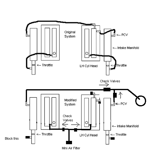

so can someone make this simple for me :wack: on this diagram which is a n/a what do i have to block and what does my catchcan plumb into thanks

Sorry to bring this back up but i have an idea to this and will get a diagram up later today but it keeps the pcvs and still allows clean air into the block.
right have done the diagram, have assumed that the pcvs are the in the same position on each side of the block, correct me if I am wrong. This is a development of a system we use on the CA18DET (uses a pcv as well) which allows air to be drawn in through a mini filter, the shit to be pushed out through the pcvs and collected in a catch can.
As I say I think this right might need a little adjustment.
Check valves are working against the PCV valves :confused: Remove the PCVs and you'll inflate the catch can with boost :D
your right sorry did that wrong, are the pcv actually on the inlet manifolds then? if so ditch them block the hole and then just use the two feed off the block that I have shown as blocked to feed the catch can.
Will work well then. going to go check my pals set up again and see where the pcv is on his car.
Nope because there's no positive purge on the crank case. You're relying on positive crank pressure to evacuate the system and not supplying clean air to flush it out... This will cause the oil to deteriorate very quickly...
