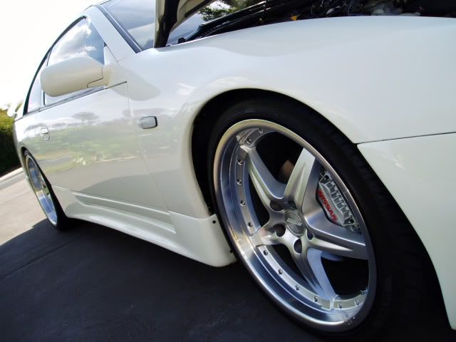

I have 19x8.5", & 19x9.5" rims. I run 235x35 up front, & 265x30 rear... & no, the 265's are not stretched.
I tried 245's on the front recently, but they scrapped badly when ever cornering.
No edit funtion! The 245's scraped, not scrapped :)
Another pic.
