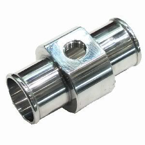

Nice one mate - don't forget that you may need an oil filter sandwich plate to plumb in your oil pressure sensor and an adaptor like the one in the pic for the water temp one as well. And maybe even an A-pillar pod to mount them as well.

oh no, all of that went straight over my head - is it really complex to install and get hold of - where would i get info for fitting all that? did you get your pillar pod from zcentre
I got my guage pod from zcentre and I'm really impressed with the fit and finish, I got one for the stereo slot too as I'm running 5 guages. They're not hard to wire up and fit, all you need is a bit of basic knowledge and some common sense. If you have bought from http://www.guageplace.co.uk then have a look in the accessories section (I think) for the sandwich plate and rad pipe fitting. If you're not sure of anything just give Nick a ring as he's a really helpful bloke. FYI, I didn't use the rad pipe fitting, I just tapped into the original sensor. When fitting the sandwich plate, make sure you use plenty of PTFE tape around the sensors and blanking plugs to avoid leaks, one of mine was leaking a bit and so had to drain all the oil and start again. :cry:
