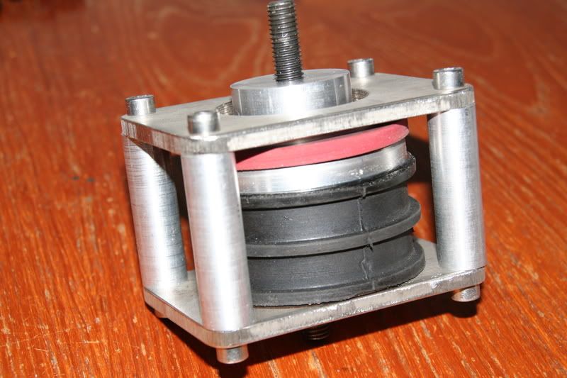

I used the original Nissan mounts on the Chevy engine but when I pulled it after about 1000 miles the passenger side one was split in two. Seemed ok when I put the engine in but will never know now.
I'm going to try these which are Range Rover mounts in a stainless cage to limit the movement if the mount lets go.
We tested some rubber mounts to destruction at work and they should handle 500ftlbs easy. The red rubber washer is to cushion the movement if the rubber does split.

Thats some mount?? How much would one of those cost?
Dunno, I made them. would be a lot cheaper/easier to have made them in mild steel instead of stainless. The actual mounts are only 6 quid each.
