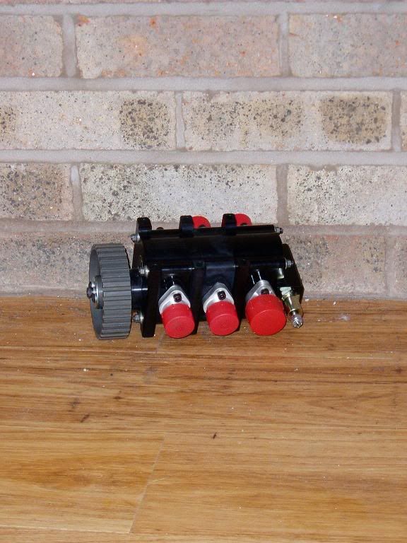

And amongst other things, one of these:

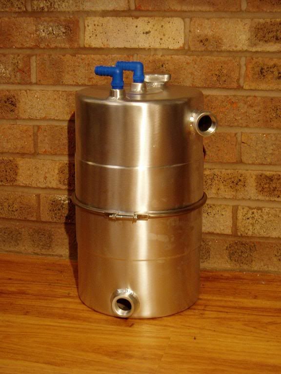

and one of these:

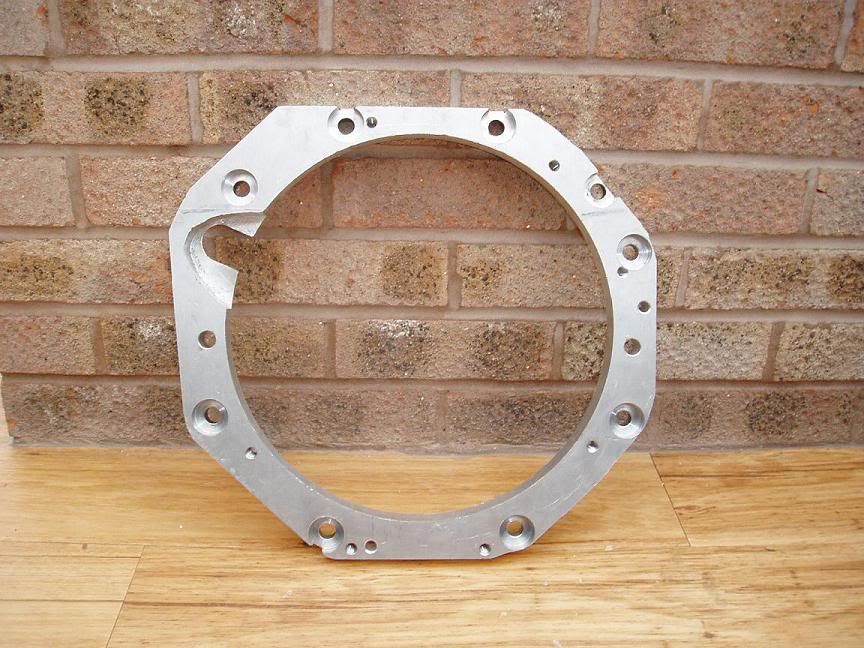

and this:

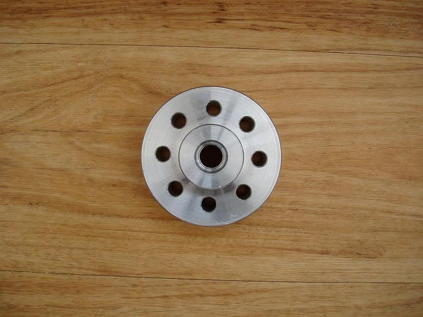

plus this:
with this:
to get this:
Anything we can do to help just let us know mate :)
As far as engine's go, funnily enough I was about to bring a great one over...if you're looking later on down the line I can get very good, genuine low miler's ready to ship from Tokyo/Yokohama with one weeks notice ;)

have you actually got a dimensional drawing for the adapter plate for the gearbox?
i do have a good reason for it i promise;)
