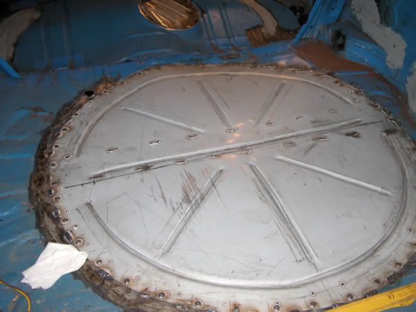

Wheel well removed to make way for the rear diff.

Some more pics this is custom made subframe which is unboltable. Not fully welded up, that'll happen when the engine's taken out again.
