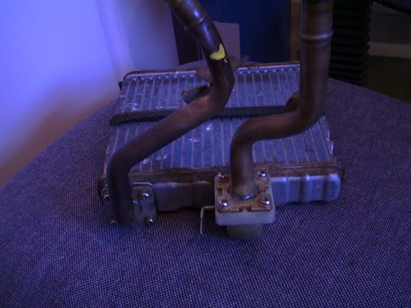

The pipes are held on to the matrix with four screws on each , if you buy a new matrix the pipes don,t come with it , you,d have to order these as well .
The pipes look like their made of brass , are you sure it,s these that are your problem and not the plastic valve on the side of the matrix , again this would need ordering as well , just a bit confused , got a piccy here to give you an idea .HTH
I havent seen anything for myself Im just going on what they saying. They have told me that these pipes are part of the matrix but, as your picture shows, they are indeed seperate parts. The question is are they accessible to change over any easier (and with less labour) than by getting to them in the same way you do the heater matrix? At the moment the car is with the company that supplied the engine to the garage thats been fitting it and they have replaced the engine under warranty and now they have realised that it was one of 'my parts of the car' that is at fault I suppose that now theyve put another engine in they want to get some money out of me in whatever way they can to compensate themselves. Basically, whatever they do its at my expense so I think best bet is get them to disconnect it, as this shouldnt cost me anything, and then talk to someone like Jeff at Zedworld about the best course of action. That way its back in my hands.
As far as Im aware matrix is fine its just one of those pipes so thats some good news if they are seperate parts because I can just get them but its still gonna be as much labour (or work for me if im brave) unless they can be swapped over from the engine bay (from underneath?) without removing too much?
