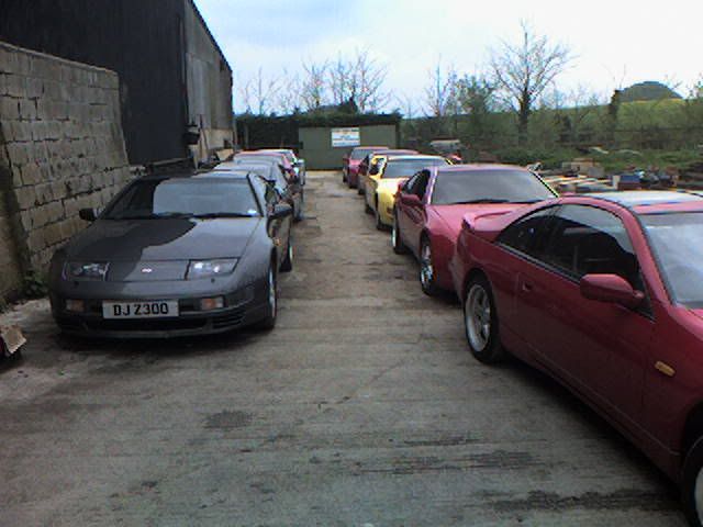

i dont want to sound daft but it happens all to often,these engines dont like high temps and you dont need to visit the z hospital :o to many are as you can see
