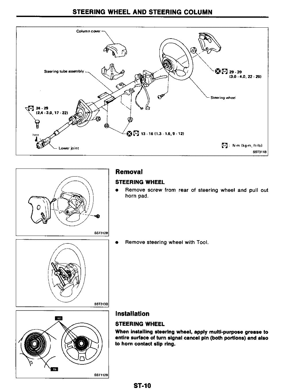

normally the uj which connects to the rack,10 min job to change,and easy to check if yours is suspect,Check for excessive play on uj,have someone move wheel whilst you check,if theres play replace
