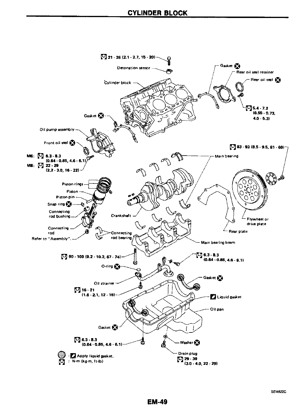

engine needs to be held up via crane,steering uj slackened,crossmember dropped,oil and filter drained,oil feeds and turbo return feeds disconected,sump removed, connecting rod caps,crank main beam,oil strainer and crank itself,also the front of the engine needs to be stripped to replace oil pump inc timing belt&tensioner and sprocket, oil pump cannot be removed without sump removal&oil strainer!
id recomend a service manual for vital specific torque settings ;)
pic of bottom end for you
Wow thats a great scimatic.
