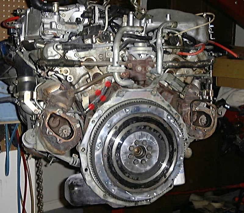

pic of rear of engine please
has anyone got a pic of the rear of the tt engine so i know what im doing when im fixing the water leak from the rear of my engine :duffer:

Dewi ive got mine out at the moment if you want to see it.
cheers some good pics there matey :hyper:
steve yeah great wold love to come down and see the engine out,
did it all go well for ya :hyper: will bring the polished water pipes when i call over :D
Here you go dewi pic of hose in question and the clips that need to be removed
HTH
Fookin hell mate good luck getting to that hose with the engine in.
its not to bad,small hands prevail

hi all i know its been a long time since this was posted but i'm havin trouble getting to the pipe pictured above. i've had the car on the ramp at work and i can squeeze my hand between the downpipe and bell housing and i can touch the pipe but how the hell do you get this off with the engine in cos i can't get the spring clips as they are facing the wrong way to get the plyers on is it just a case of pulling it off and if so will any piece of water pipe the same diamiter do the job with some new clips PLEASE TELL ME HOW TO DO THIS !!!!!!

Try using long round nosed pliers to gat to the other side of the pipe.

I had the same problem with the clips facing the wrong way when I did my PCV valves. :headvswal
tried them and got my arm stuck it was'nt funny at the time but i laughed about it on the way home i thouht i was gonna be swingin from the bottom of the car all weekend i'll just have to give it another try and see what happens and try and find some pipe at work cheers lads. Oh and paul i still aint seen your car i'm only down the road from you we'll have to meet up at a cruise or something cos i'm sick of sittin in the house, lol
thanks vijay and mark thats spot on i'll try and get it done at the weekend so just samco stuff will do the job then i've got some lyin about from when i done my dump valves.
You need the 8mm reinforced stuff not just the 8mm vacunm pipe.
great stuff mark i've got some of that too cheers mate oh nice engine by the way
