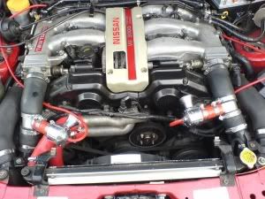

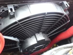

Have had a great day all day today on my Z! :D Completly removed my viscouse fan cause it saps power and fitted a nice big Kenlow 16" er which was an absolute bitch to bitch having to take the rad out but it's well on there now!! Then had to remove my oil cooler cause it's a UK Spec car, standard electric fan just to get to the original recirc valves to remove them!!!

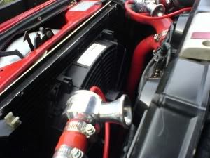

They we're a bitch in them selves, easy to remove but then trying to bung up the recirc pipes was a nightmare!! The top hose requires a 28mm bung and the bottoms 32" :headvswal thats the bloody japanese for ya!!! Then I spent the afternoon chopping up the intake pipes to fit my new baily venturi dump valves!!! Put it all back together and it all worked first time!!!
Just a quick question though i've disconnected the vaccume pipe from the original recirc valves completly as I feel there know longer needed and have connected the vaccume pipe from the baily ones in it's place.. Are they used for anything else?? :confused:
PS By the way got the car dynoed befor and after viscouse fan removal and for those that need to know when the viscouse engaged it saps a wopping 18.3 BHP!!! The electric kenlow only sapps 0.4Bph as i guess the alternator has to do some work!!! Good upgrade :D

No, forgot to mention sort off took that into consideration by sticking 2 little 9" Pifco fans just in front of the intercoolers just to give them a bit of air flow!!! ;) Your right though the IC's still arn't gonna be getting max airflow through them, next time we meet around christmas hopefully you can see the install for yourself!! Definatly I worth wile mod in IMO... :D

Again, like you say it's only a simulated test but you can set the Kenlowe fan to cut in at what ever temp you like as it comes with it's own ajustable thermostat. ;)
Just an interesting note on the way home from work this evening I have the interior fans on in the car set to 30Degress so I was nice and warm, then after a quick blast up the duel carrage way the car got hot so the Kenlowe kicked in and did it's thing, it is that efficent at removing hot air that the interior fans actually started to blow out cold air until the Kenlowe switched itself off!!! :cool: Need to set the adjustable thermostat to come on a bit later up the tempreature band I think??!!!

The pics..
The pics..

Hopefully these are larger cause of original hotmail reduction!!
I know how to post piccies now!! Thanks Scotty!! :D
