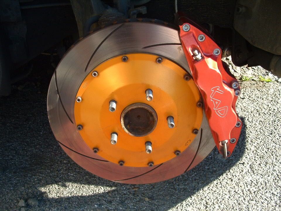

KAD 6 pot kit with 2 piece 356mm discs, she stops pretty well now ;)
smithy
They look great, thanks for the good phot. I've been looking at their website. I take it they are the ones advertised for the skyline? How much were they?
Dave
1.5K for the complete kit mate, however even though they are meant to fit 18" wheels, which i have, we had to get 5mm machined off the height of the disc to fit inside my Antera's and leave the required few mm space between caliper and inside of rim. They also do a 343mm version if needed.

Are your anteras the same as mine? Do you mean you got it machined yourself or the company did it?
Dave
I had them machined myself as it was quicker and easier, a local machine shop who do this sort of thing all the time done em for me for 30 quid the pair.
