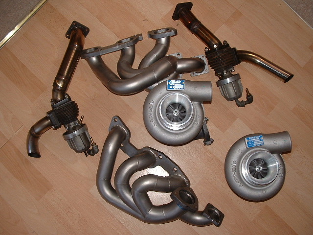

My Tubs wastgates and manifolds

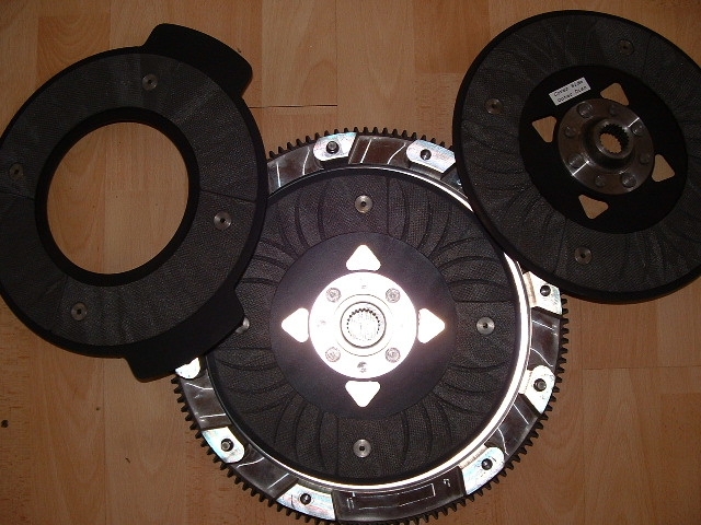

My clutch

My clutch
But look at your results, fook that looks tough :D when will it be finished? and i gather you must have had a few internal mods to?
