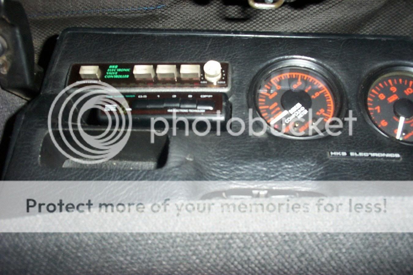

HKS valve control how does it work
This is in the glove box
What does it all do?
how does it all work?
do I need it?
if not can i sell it
what should the boost control be connected to(electrically)
the HKS electronic valve control
has a boost level button
3 big buttons and one dial which goes from min to max
the loom behind it was disconnected when i looked
should it be connected to the ECU
dont know how to work the turbo timer

Looks like you have an HKS EVC 1 boost controller. There are two main parts to the system - the controller which you have seen and a control valve unit which should be plumbed into the turbo wastegate actuators.
This is what the two main bits looks like:

should this be connected to that?
Any chance you can make the picture bigger. Can't quite make it out.
there you go
just trying to get the thing to work
yes it should. The EVC will allow you to increase pressure (boost). Depending on how you have it set up it will probably take readings from the vacuum pipes.
ummm...... interesting. It certainly looks like a boost solenoid although perhaps a little on the small side. However, it looks nothing like mine and I also have an EVC I. Attatched is a picture of the boost solenoid under my bonnet.
The link below that Andrew posted gives instructions on what pipe goes where.
http://www.hksusa.com/info/download.asp?id=1739
As for the wires that come out of the head unit in your glove box, they chould connect to a wiring loom coming from the boost control solenoid under the bonnet.
