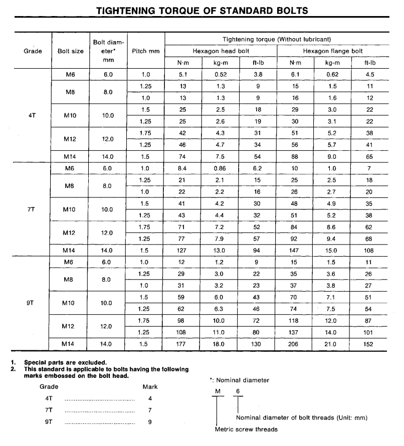

Does anyone know the torque settings for the oil squirters bolts. I can't find the information anywhere?
I found a video where they state around 10 n/m if anyone is interested
Edited by gmaxg98
Many thanks now I need find out what grade of steel it is
