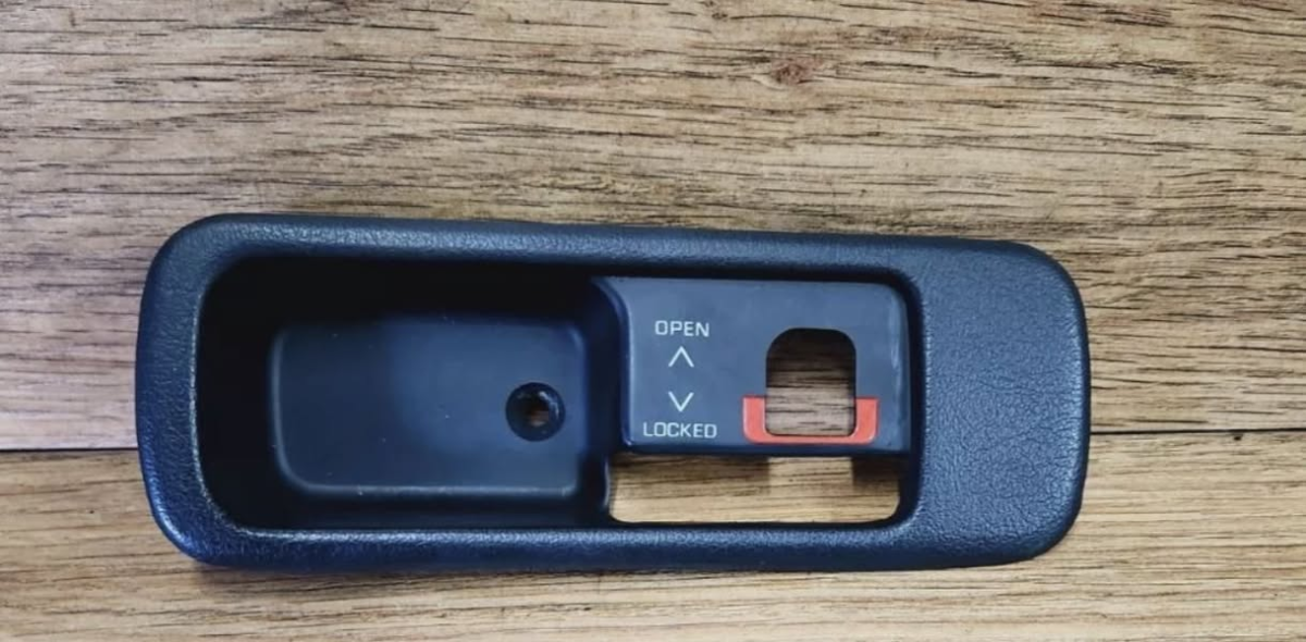

WANTED: RHD Drivers side targa panel handle surround.
Like the below picture but opposite side. If anyone has one, please let me know as mine is snapped in two ☹️
