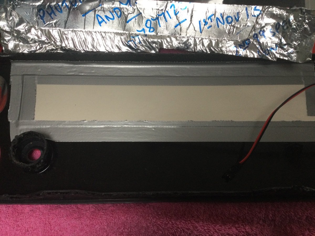

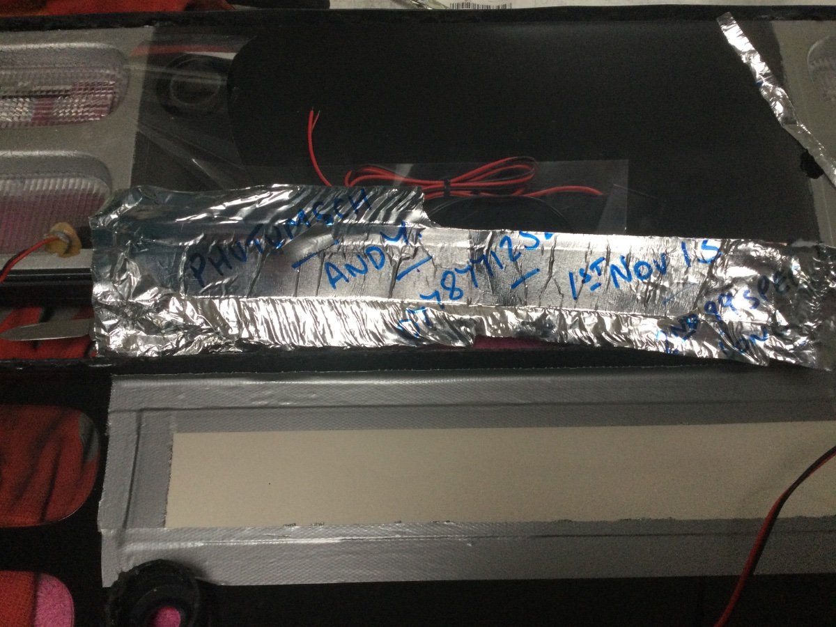

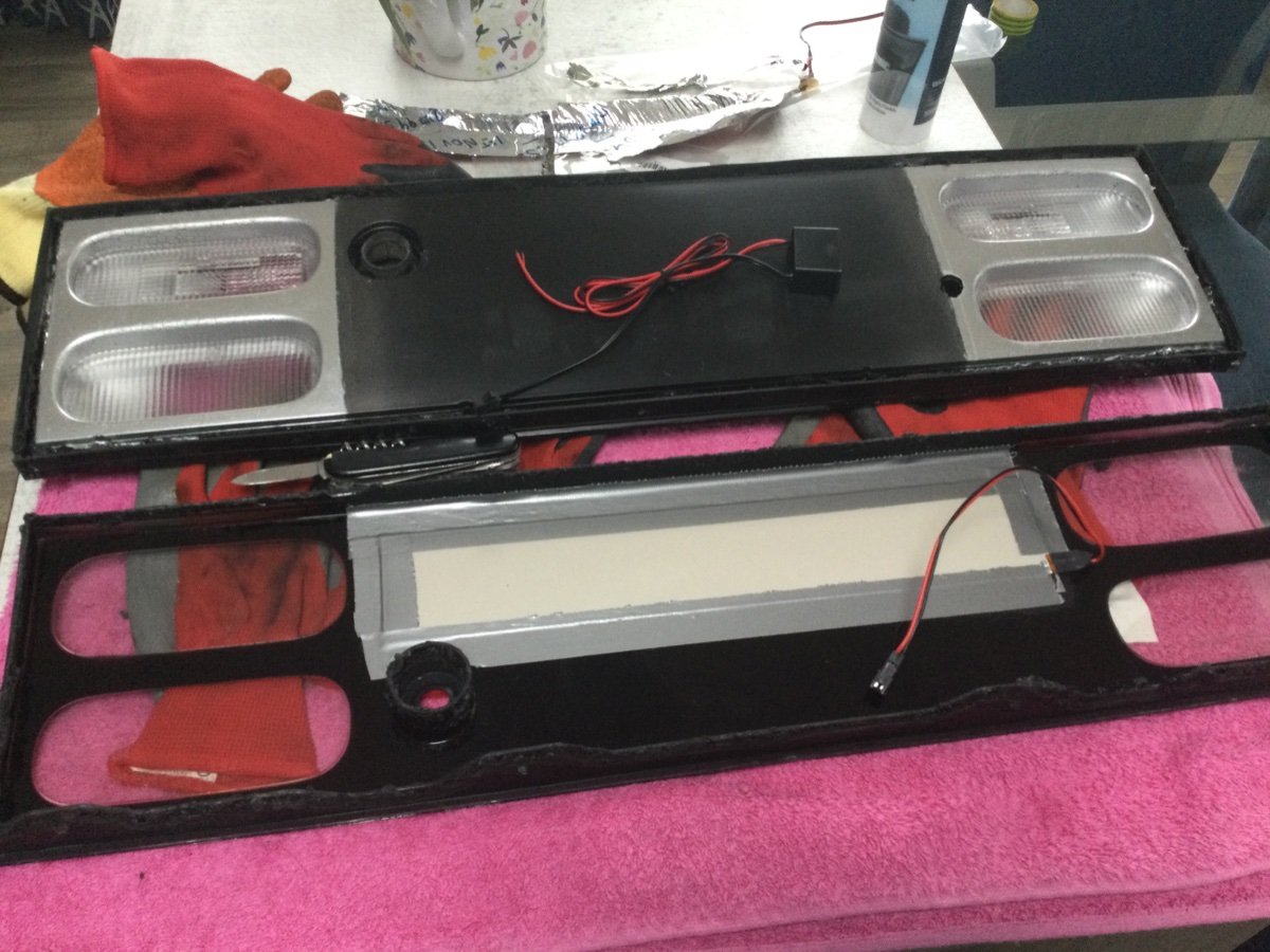

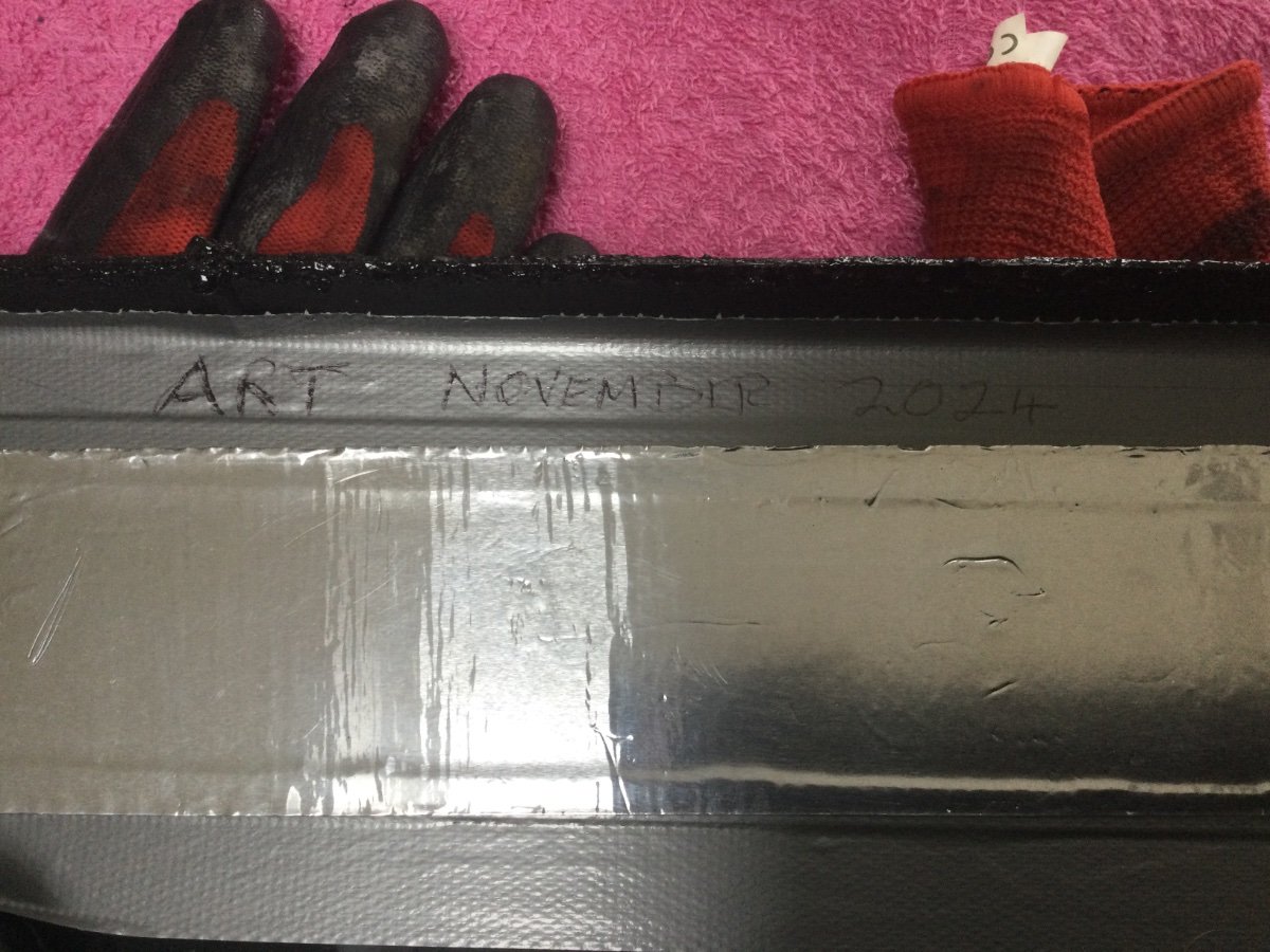

If you mean splitting the panel open then this might be of help to you.
http://www.twinturbo.net/nissan/300zx/tech/illrp/illrp.html
It took me 30 minutes to heat & separate!
taking care not to crack or brake the panel
new light trip in place
All back together
sorry about the phone number!
I hope it works after all this😀
