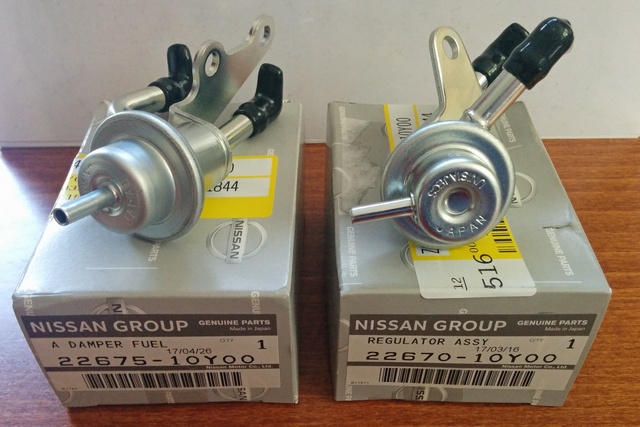

Running extremely rich is also a symptom of failed damper (FD). It's worth replacing the FPR and FD as a matter of course as they
can fail with age. Details in link.
http://www.twinturbo.net/nissan/300zx/forums/general/view/2610744/Here-is-how-it-works.html
