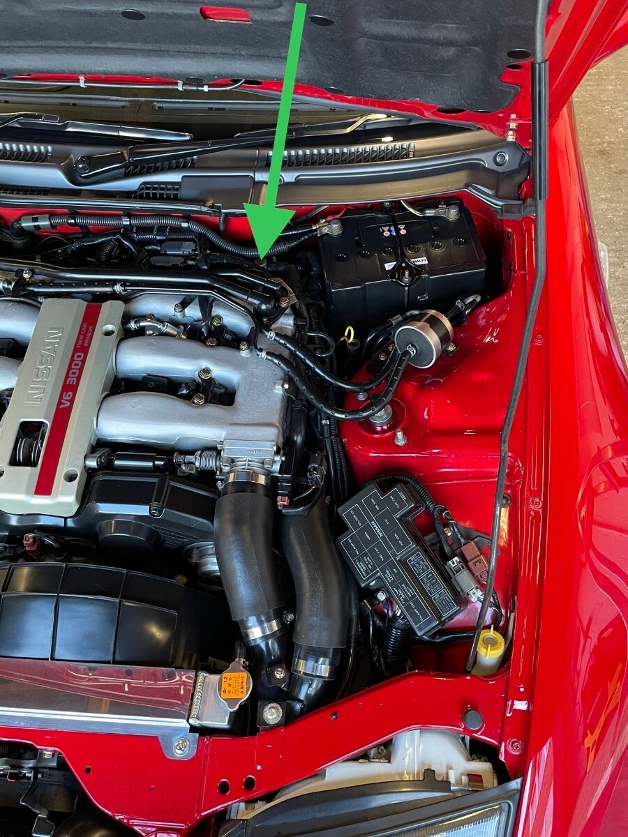

Whilst searching for the still illusive idle adjustment screw I came across these two plugs going nowhere!
1) Does anyone know what they are? They are adjacent to the auto gearbox dipstick (see photo).
2) Does anyone have a picture where the idle adjustment screw is located on 1991 TT.

The Idle Air Control Valve (IACV) can just about been seen with the green arrow in the pic below. The adjustment screw is on the side looking at it from the battery. It’s a little bit tucked away!
Thanks Joely - I will have a better look in the morning for the idle control screw. New coil packs, injector plugs and spark plugs have cleared the lumpy running but I am left with a high (1400rpm) warmed up idle. Haven't adjusted the idle for 20 years and has always been rock steady at 800ish so not convinced that is the problem. No Consult errors. Any thoughts appreciated.
