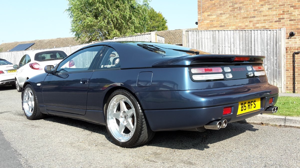

Hi Simon,
My wheels are pretty much the same size as yours, albeit my rears are (IIRC) 9.5, and I'm running 235/40/18 front and 265/35/18 rear. I'll probably go 275 at the rear next time though 😉
They fit fine, no scrubbing, with my Zed having been lowered 25mm on Meister-R coilovers. Any excuse for a Zed pic LOL
Thanks guys for the replys. That's the sort of fitment look I'm after Richard. That tables helpful, 265 rears it is then.

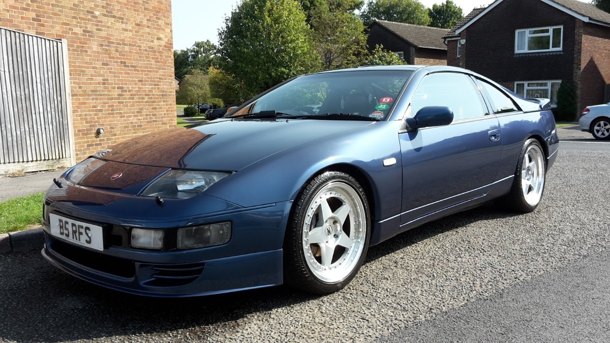

As promised, pics of the new wheels. Not sure if i like them yet, it's so hard buying wheels without seeing them.on the car.20230910_163430.jpg.a4698708d275fef4910285d321cc66dd.jpg
