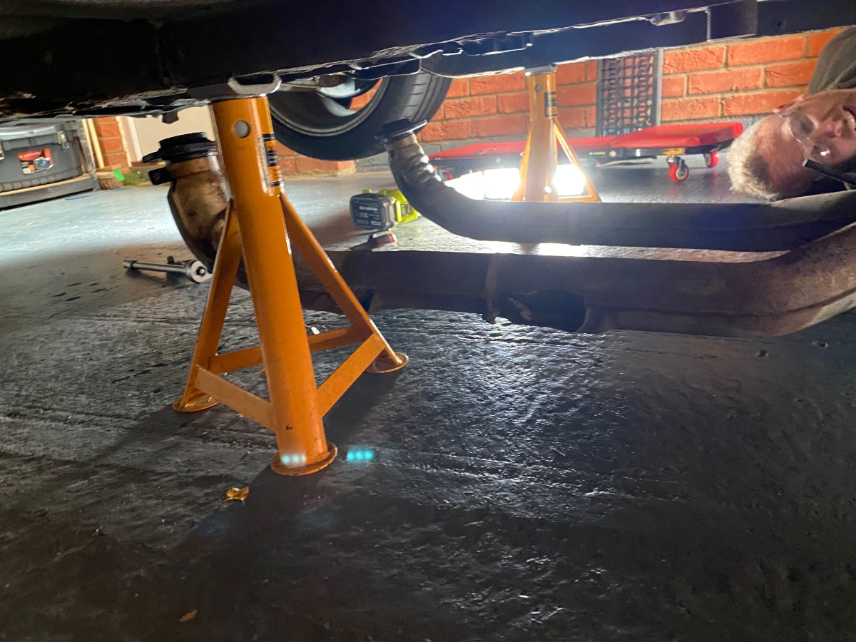

I’ve had to take the Cat section off the car to drill out some boned bolts. To do so I had to take it off the down pipes from the turbo and the bolts were very loose.
Does anyone know the torque settings for these?
